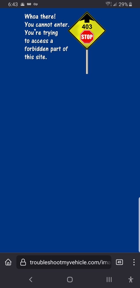

Your first link is no good.
Not sure why you got that, maybe you are BANNED from the site :)
OK fine, posted an alternate image link
