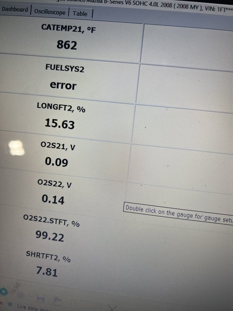

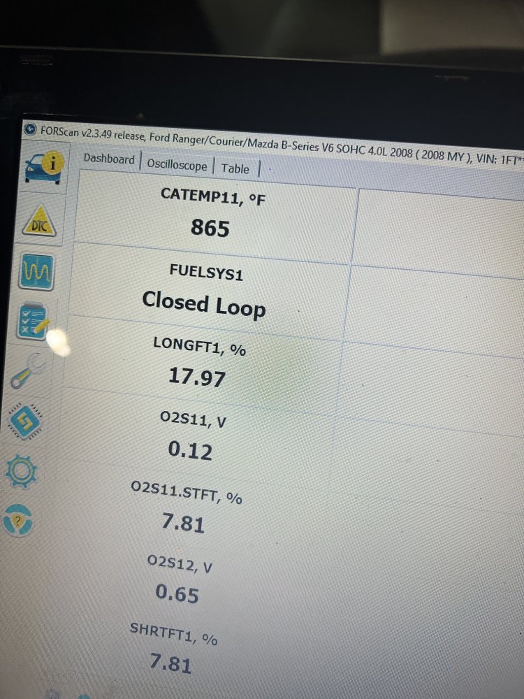

*Forscan O2 test shows a “Fuelsys error” on bank 2.
I have attached the screen shot of the test for bank 1 & 2 .
The 02 sensors are original so they are most likely in need of replacement however I’d prefer to find the cause of the problem first.
I’m “guessing” that there may be a fuel injector leaking down due to the 10 psi drop as mentioned and that it could be located on bank 2 because of the o2 error.
Or is it just an sensor error only? I’m over looking something?
