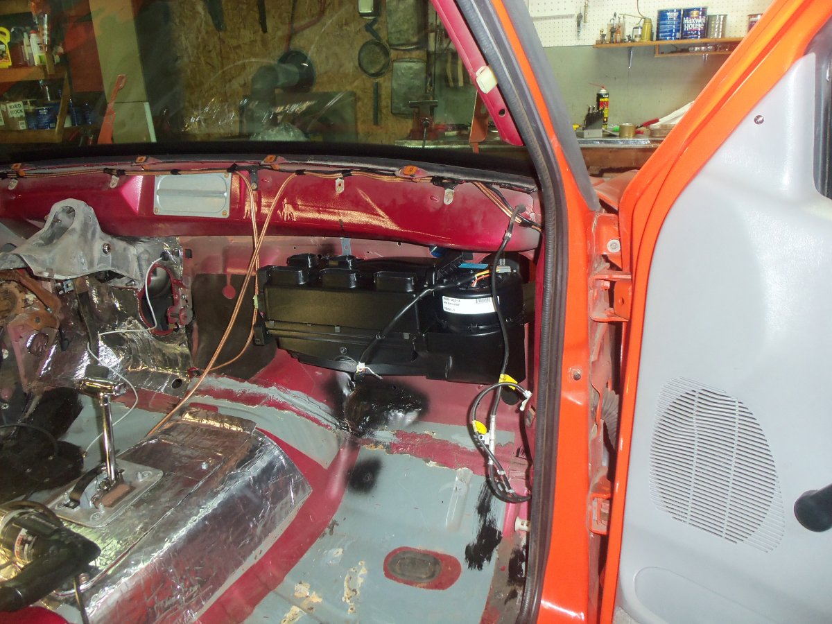

My truck had no HVAC system at all so I got a Vintage Air heat/defrost/a-c system. The heat and a/c work OK, the defrost function is lousy because the unit uses recirculated air, so I called them. They're in Texas and couldn't imagine why I'd want to pull outside air into my truck. If you have a functional heater and defroster, they sell an underdash a/c unit that looks like something you'd see in a mid 60's car.

My truck had no HVAC system at all so I got a Vintage Air heat/defrost/a-c system. The heat and a/c work OK, the defrost function is lousy because the unit uses recirculated air, so I called them. They're in Texas and couldn't imagine why I'd want to pull outside air into my truck. If you have a functional heater and defroster, they sell an underdash a/c unit that looks like something you'd see in a mid 60's car.View attachment 75999
Thanks, I've seen these Vintage Air units for sale on eBay, but no instructions on how to install. So I will check out their website.
