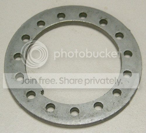

Does your spindle have 2 nuts and a ring in the middle with holes around the border?
Looks like this:
It looks like that but there isn't holes in it its just solid round piece.
I am not sure what an 86 would have had from the factory as far as the nuts and washers are concerned.
I know on my 94 that I had the inner nut to tight on the bearing and that destroy my drivers side front bearing prematurely.
Since then, i learned that the inner nut gets snugged up to the bearing so there is no play, but don't crank the hell out of it. The inner nut had a stub that stuck out and fit in one of the holes on that washer and the washer prevented the inner nut from moving with the groove in the spindle. Then the outer nut could be tightened down good on the washer and inner nut. This keeps light pressure on the bearing, but ensures that the nuts will not come loose.
Can someone comment if the earlier Ranger's washer had holes in it like the one pictured above?
86MUDRCJ, does your Ranger have manual or auto hubs on it? Your's does have two nuts and a washer, correct?
It has manual hubs and I believe it does. It also has springs in front of the inner nut.
