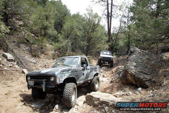

I've had quite a few posts and PM's asking to see pictures of my truck, yes I am the poster formally known as 1badb2. I havent had alot of time to be online in the last year and a half since I joined the army, Im currently PCS'ing to Ft. Polk, LA (sucks I know) but it is what it is...
Here are two previous "forms" it was in, that the older board members will remember.
basically the truck held up to about as much as it could and was literally falling apart... I now have nothing of the original truck left other than part of the shell.
Most recent pics while I've been home on TDY/Leave... I'm towing the B2 back to ft polk with me.

the front axle swap was not finished... it was able to sit and move around under its own power slowly and that was about it. Needed steering finished, front d-shaft made, castor fixed, shackles finished, ect....

specs.. hmmm lets see if i can remember everything.
Semi-Float rear D60, 35spline alloys, spool, 5.13s.
D60 HP front, 35spline inner and outter alloys, warn hubs, locked, 5.13
ballistic covers, Hi-steer, hydro assist
D.D. Machine doubler- 1350M crawlbox, 1354M rear case
FM145 transmission, centerforce clutch
2.8 w/ modded 2150 carb, soon to be TBI, cam, non-EGR heads, flowmaster cat-back.
2400cfm derale fan, 3core modine radiator
GM 1-wire alternator, optima yellowtop
caged....104" wb, frame chopped 20" off the rear, stinger bumper obviously, trailgear 3" leafs front and rear, 39.5 bias iroks. Corbeau seats, 8gallon line-x'd JAZ fuel cell, electric fuel pump, on board air.
