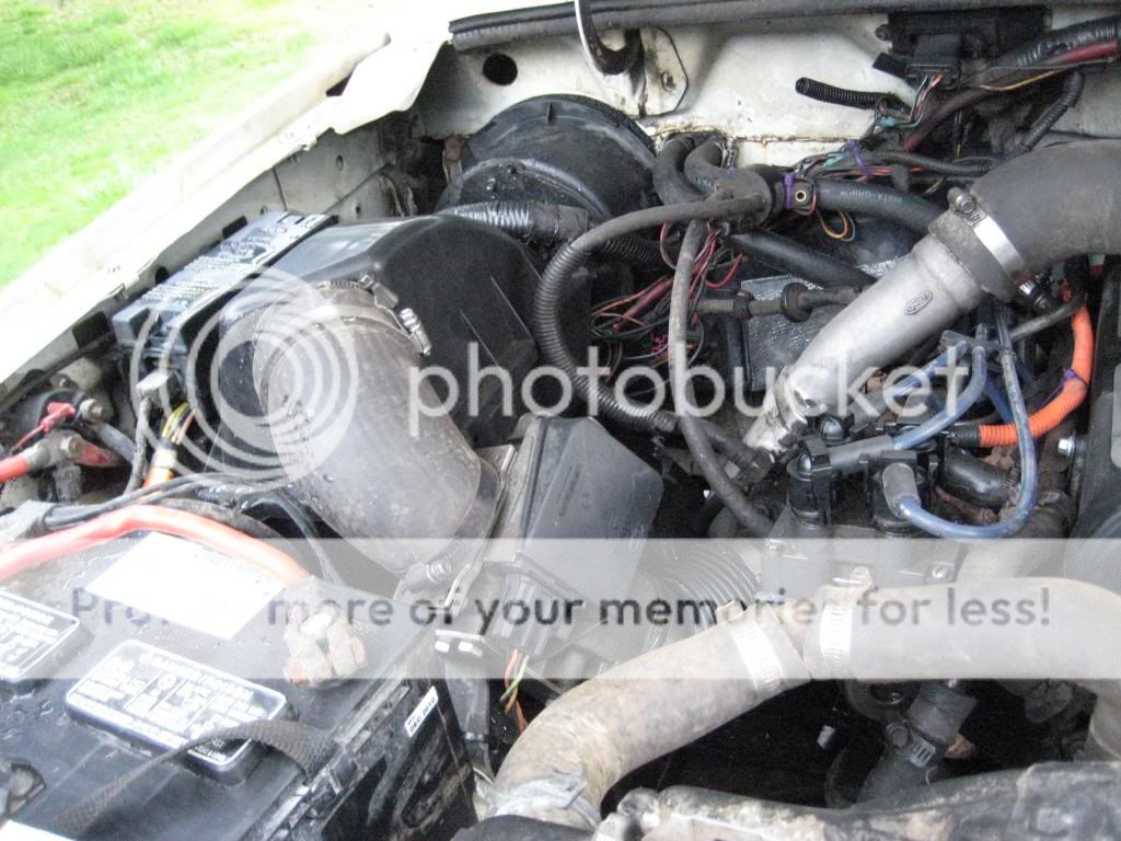

On that 3 bolt pattern, picture a 4th bolt in the area over the fuel pump hole, the Ranger bracket uses a bolt there and it will need to be drilled and tapped, that's what I did and it's been working for a long time and I haven't been using a support from the power steering bracket to the intake like I'm supposed to... Other than that it bolted right up. Here's some pics of my engine compartment:
You might be wondering about the air filter box... I used the stock lower part but the upper part from a 2.9L Ranger without a MAF sensor and got the intake tube from it too and trimmed it to fit in that way, there is a piece of PVC inside the hose to hose clamp spot, that works much better than my previous attempt, also made a bracket to hold the VAM to the battery tray (there's one random bolt hole tab on that corner of the tray, I used it).
I'm running all T bird engine parts with Ranger external parts, I've heard all the horror stories about the TFI ignition and have liked the distributorless ignition for it's simplicity so I kept it on my turbo engine which like I said earlier just needed the crank sensor mounted. For the DIS I had to extend the passenger side coil bracket to avoid the coolant line to the turbo or oil cooler (or both, I don't remember). To run with just 4 spark plugs all you gotta do is ground out the outer two wires on the connector for the drivers side coil pack but like I said the tach won't work (I need to figure that out...).
Your stock wiring harness should be able to be used, you'll just need to move a handful of wires (don't forget to pull out the wire telling the computer the fuel pump is turning on, that goes to the octane switch, that was the cause of a lot of pinging on mine before I figured that out!). If you can use your stock throttle, it'll keep you from having to adapt to the older connector for the T bird throttle.
Also, the roller cam in your Ranger engine is probably still in good shape, throw that in place of the flat tappet cam that's in the turbo engine, it's apparently an upgrade...

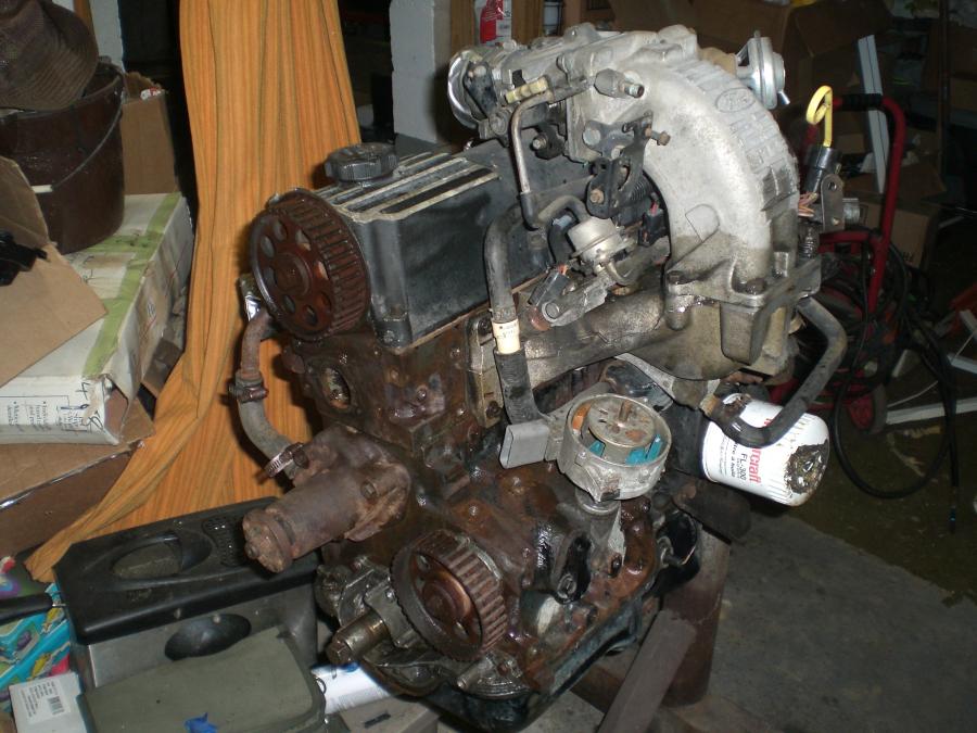

Scott, I have a pretty solid plan now, and your advice has really helped a bunch. I think my turbo motor is an 87' or 88'. ??? It does have the one piece gasket. I'll post a pic. I like the idea of using the roller cam from the Ranger, and added it to my to do list that keeps getting longer. LOL.

Yep, that's an '87 or '88, if you have the LA3 computer for it you have the best they put out there...

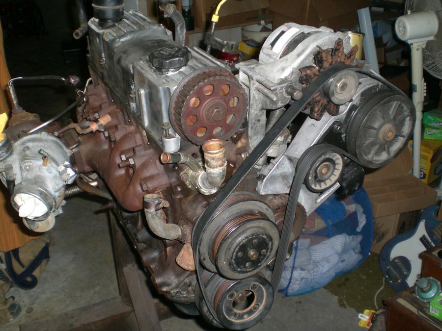

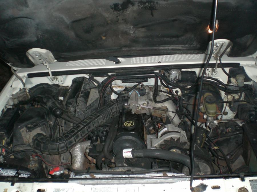

Well, I've made some progress. Have all the alt/steering pump and heater box issues worked out. (I built a steel plate to allow the alt. bracket to bolt up to the TC head. works really good!) Going to install the Ranger roller cam set-up next and then the "Fun stuff" (not really lol) Wiring, computer, sensors and such. I posted a question on forced induction today regarding the use of the stock computer/MAF for minimal amounts of boost. I'm moving to Oregon this summer and would rather finish the job there. Parts are WAY cheaper and more plentiful than they are here in TN.
