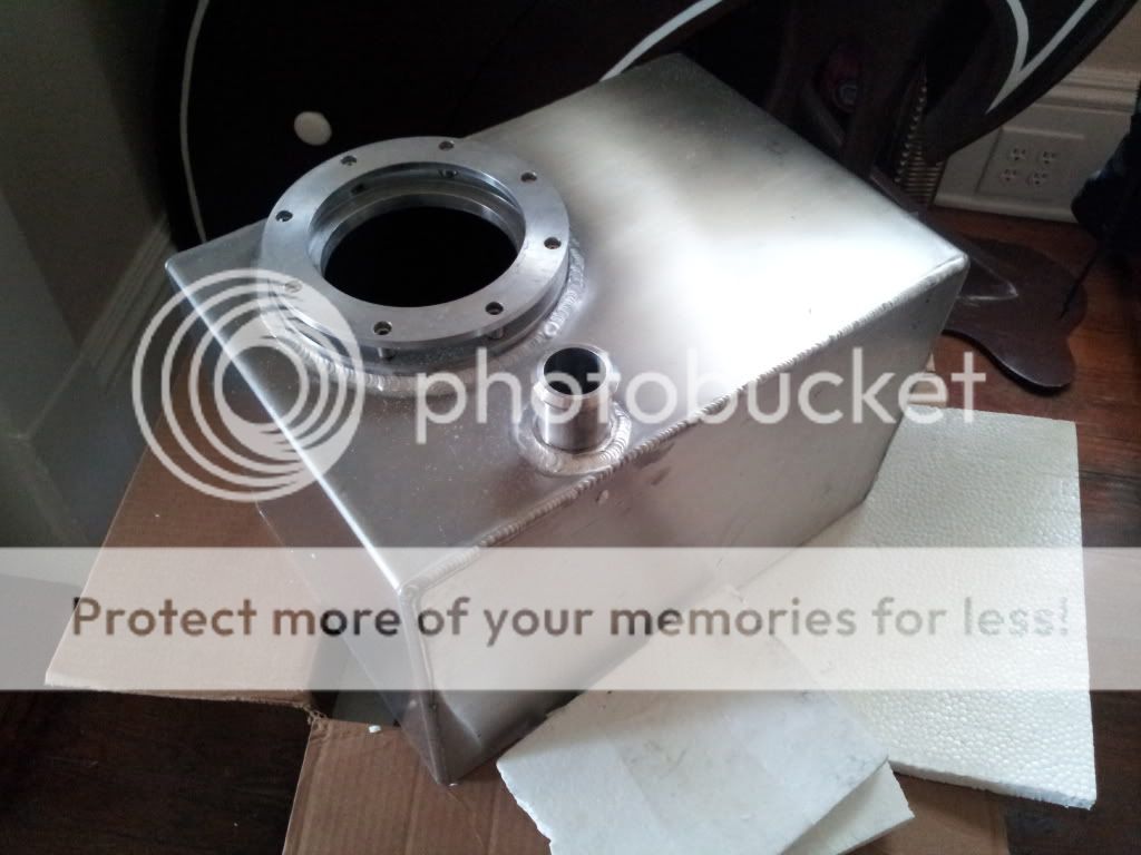

hey whats up guys, i had the gas tank built by a guy on here at crazy talk customs and wow!!! he did a awesome job and machined a adaptor to fit stock tank sending unit in it. been doing the little things on it that takes forever to do so now we have started to figure out the wiring set up.

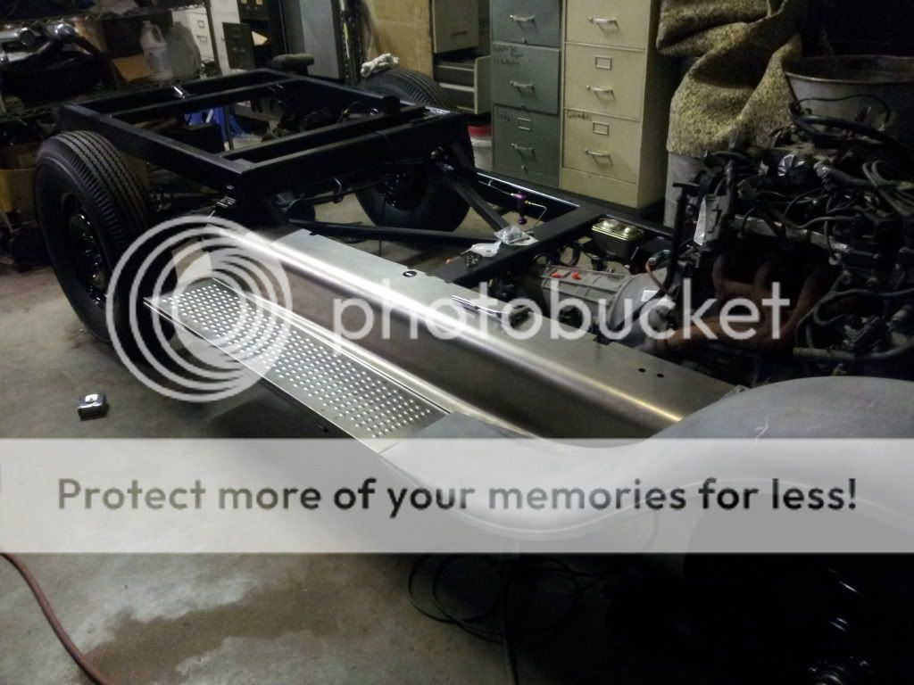

andy d....this truck has disc brakes on the front. i took the stock model A suspension out front and back and now have a new straight axle with mustang2 front disc brakes from speedway motors and a stock 1999 ford ranger rear end with ranger leaf springs. i love traditional hot rods with flatheads and all but i wanted something deadnutz reliable, better on gas and something that can take the beating of everyday use while still being a 1928 ford pickup. i scrapped the stock model A chassis andme and my buddy built a homemade 2x4 chassis with a K member.

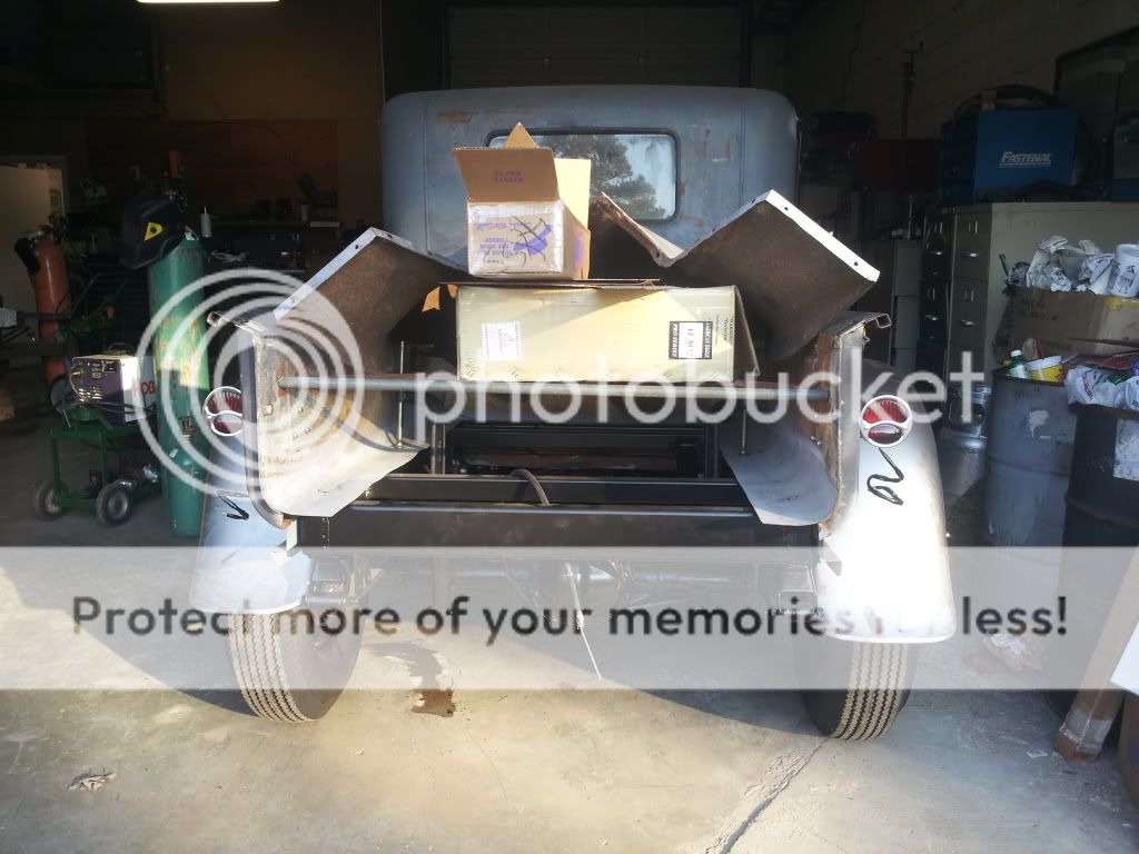

here is a rear shot where youll see the ranger rear and leafs and i also used the stock ranger shocks
here is the fuel cell built by crazy talk customs that i found one here that has a machined adaptor that accepts the stock ranger sending unit.
