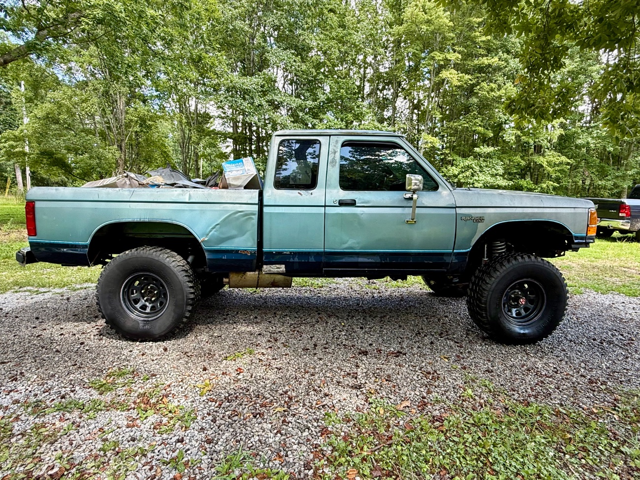

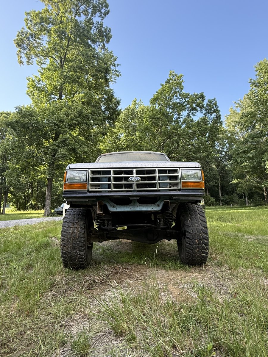

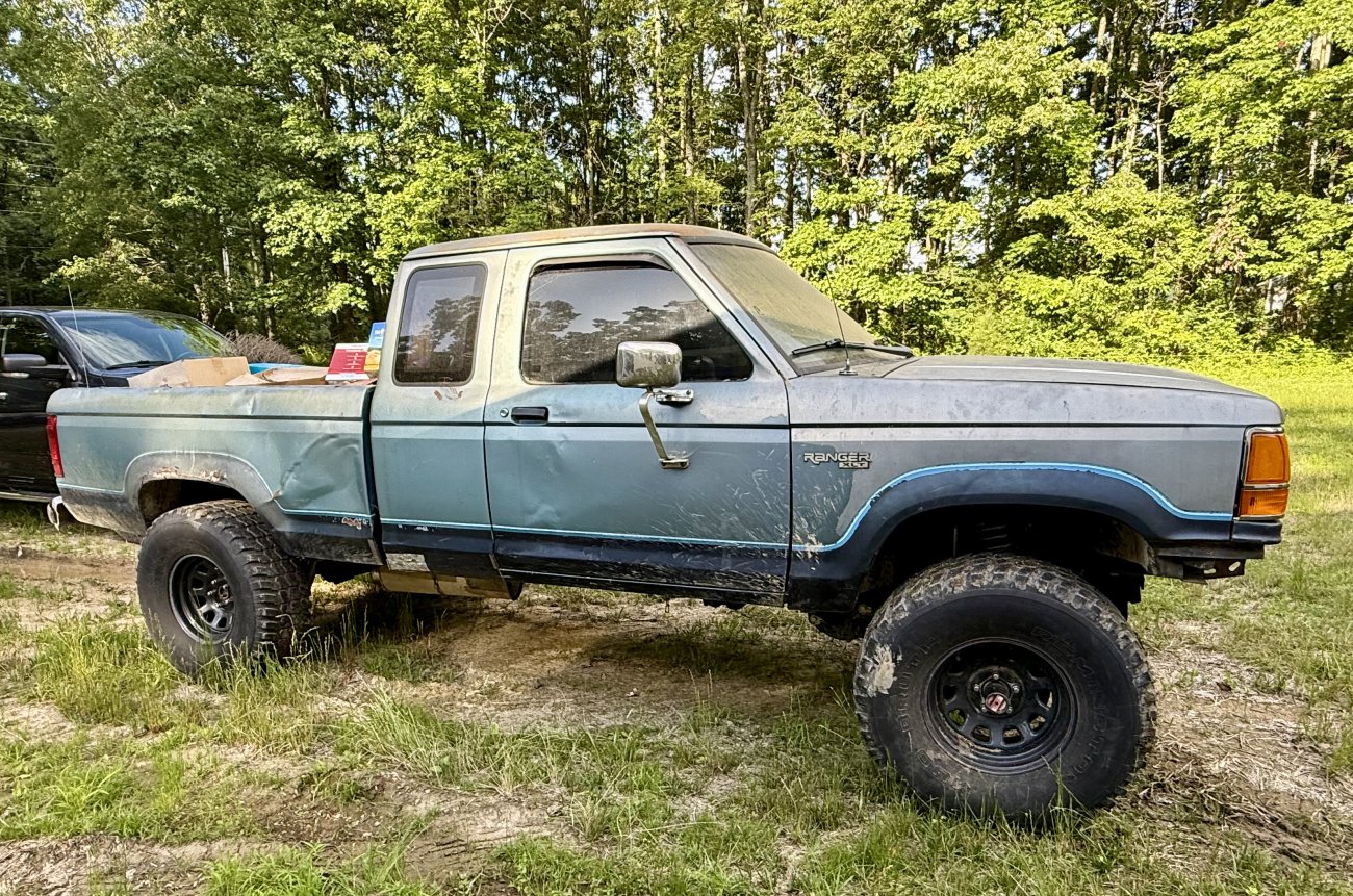

The 4” lift is finally on. Now to replace the rear brake lines, cut the fenders, and get to work on the interior cleanup.
Well then...that's pretty cool. Well done. :pray:
