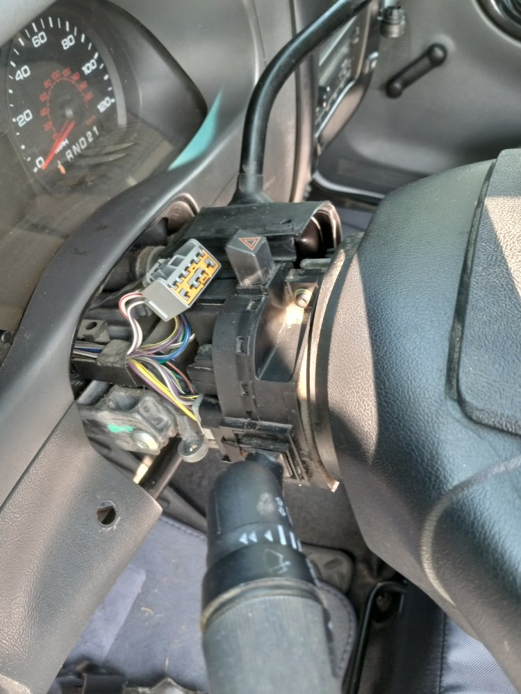

The actual 4 way flasher relay is just to the left of the steering column, I replaced that initially. The 1st photo is the steering column 4 way switch (plug removed). I reconnected the battery and there was no "clicking", however I don't think there was any power to the relay, as I think it's powered from the plug. Upon re attaching the plug to the 4 way switch, the "clicking" returned.
The 2nd photo shows the second plug, but I haven't been able to disconnect that yet. When I do, I'll post pics and my findings. Thanks to all for your input.
No, the flasher is powered by 2 fuses in SJB, the multi-function switch activates the flasher
Either the 4-way or the turn(key on)
Look at the diagram
If flasher does not click with multi-function switch unplugged then fault is most likely in multi-function switch
4-way switch is part of multi-function switch

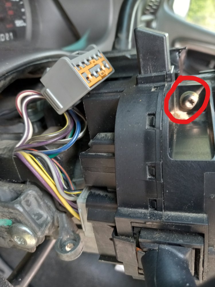

Just two screws and the whole unit comes out, easier to disconnect wires that way

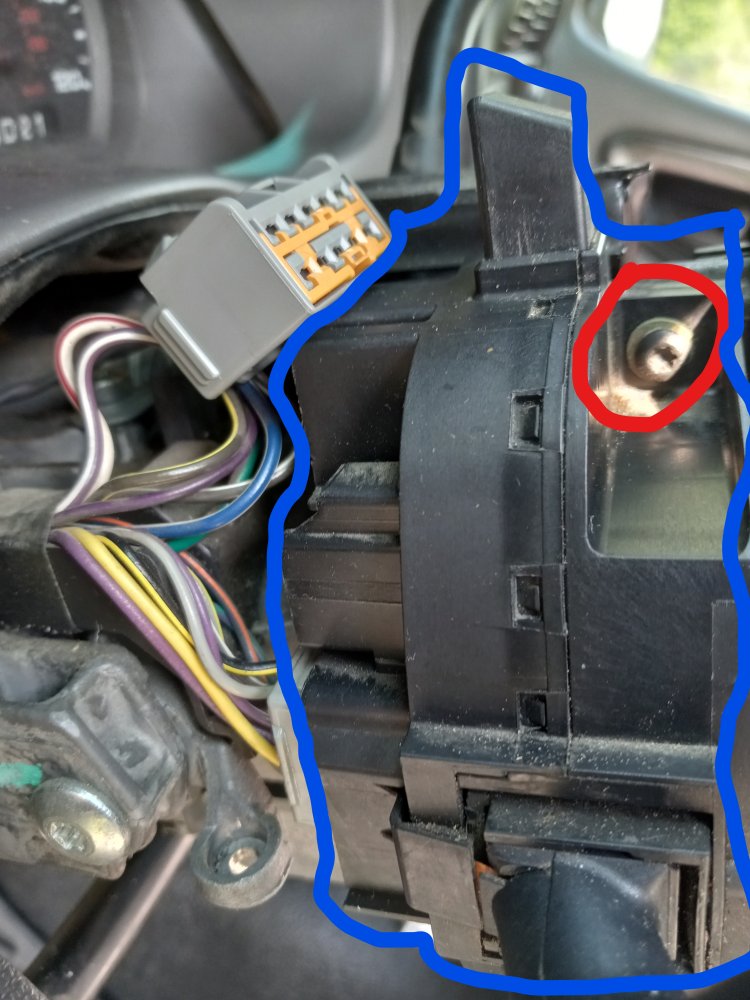

I've attached two photos. One with a screw circled in red, the second is the same photo with the "unit" outlined in blue.
1st: is the screw one of the two for the multi-function unit?
2nd: is the "unit" I've outlined, the multi-function unit?

Yes, that's one of the screws, other is in same place but on underside of the multi-function switch
Screw head is called a Torx type, you can get Torx "bit sets" at places like walmart or ??, for $6-$10
Like this: https://www.walmart.com/ip/11PC-Tor...-Driver-Drill-Security-Tamper-Proof/631836255
They don't need the hole in the center, but if they have it it can then be used on "security" torx screw heads as well as regular torx screw heads
Yes, the blue outline is the multi-function switch
Thanks so much. I'm a retired police officer and not an auto mechanic, however I can follow instructions. I also know that pics help the instructor (you). I appreciate your time and efforts in assisting me. I'll be back with follow up questions, I'm sure.
Well, RonD, it appears that you know your Rangers very well. I removed the multi-function switch as directed without a hitch. After following your directions it appears the multi-function switch is bad. I'm ordering a new one, and I think, thanks to your directions, I can replace it and resolve my problem. Thanks for being patient with the FNG on the forum. I'll get back and let you know if I'm successful.
