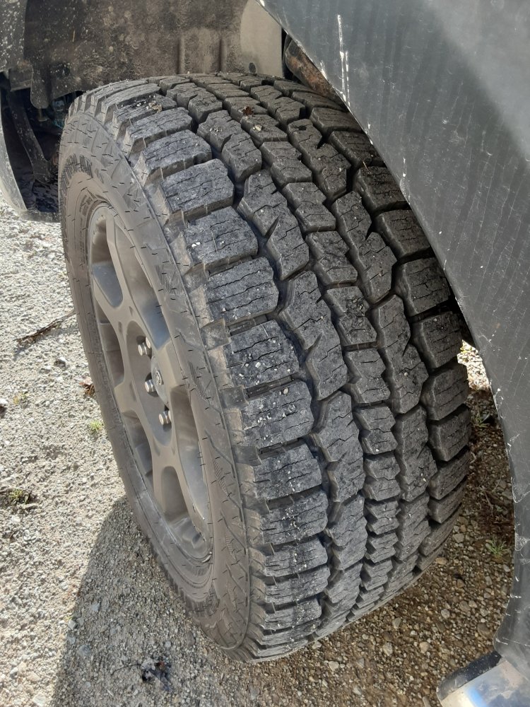

I thought it might be worth a look anyway. Is the new tread more aggressive then what was on it?

.... Is the new tread more aggressive then what was on it?
Yes, very much. Sorry I don't have an image of the old ones. They were were just 275/55R20 111S - probably all season or something like that.
Here are the new ones: 305/55R20 AT

I'm sure part of what you're hearing is the new tread... I'm sure they make more noise then you're use to.
Agreed, and when you put it in 4x4 on the dry road, it will cause just a bit of binding in the drivetrain so those loose, tall tread blocks are under load and that makes the noise change.
