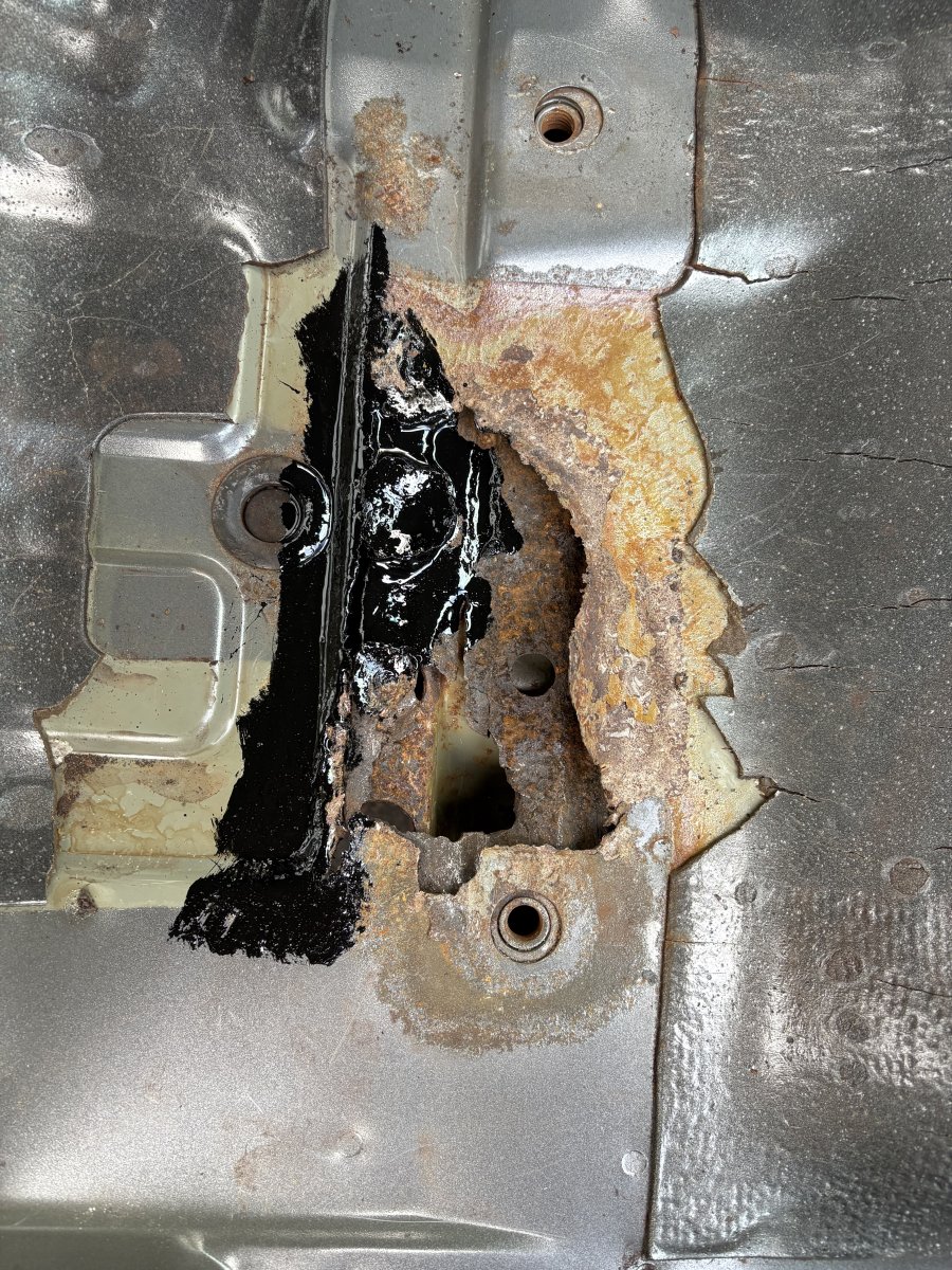

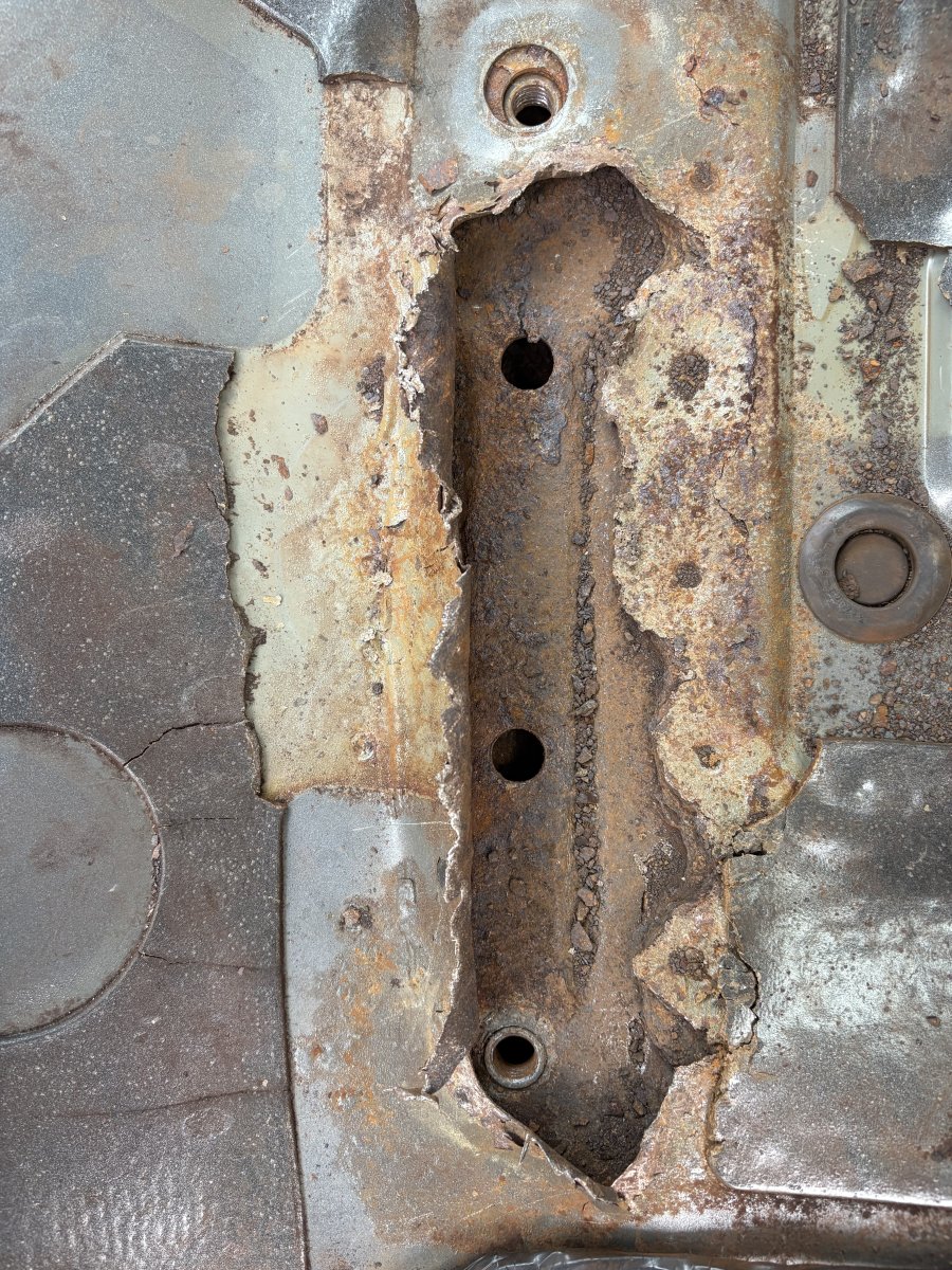

I had to veer off the path for a little bit. Found some spots that are rotted through the floor. Cleaned them up with the needle gun and treating them with POR15. Then I’ll fiberglass over them.

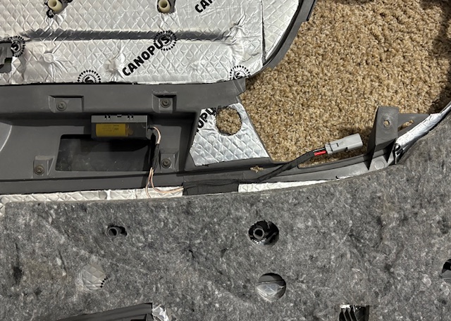

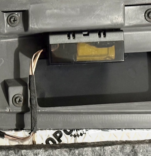

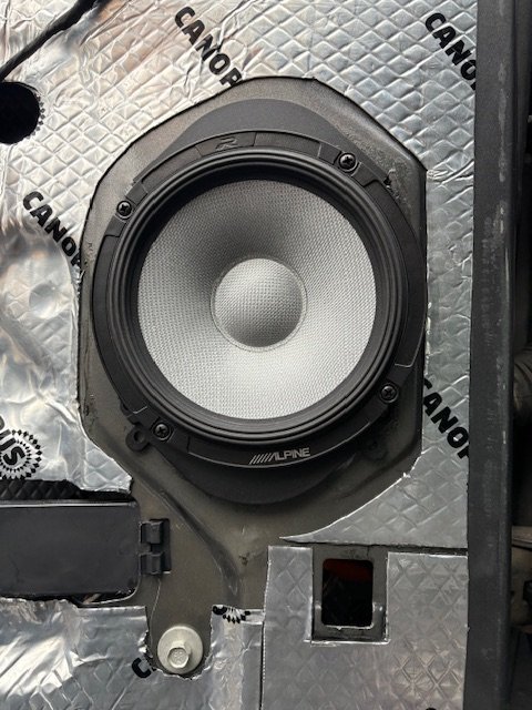

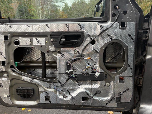

OK, back on track. I got the sound deadening finished, the door panels all wired and the front speakers in. I had to trim the lip around the speaker opening on the door panel because it was hitting the adapter. I tucked the crossover up under the armrest. Fit perfectly.

I used a two-pin Deutsch type connector for the door speaker so the panel can be removed easily. It's starting to come together.

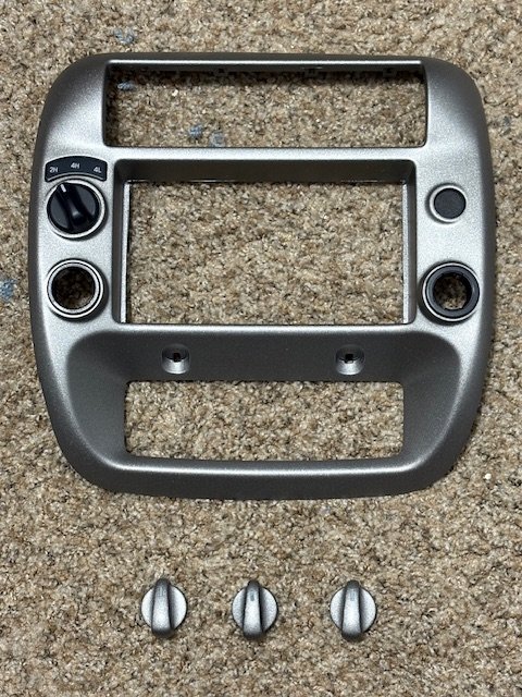

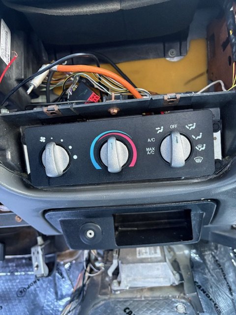

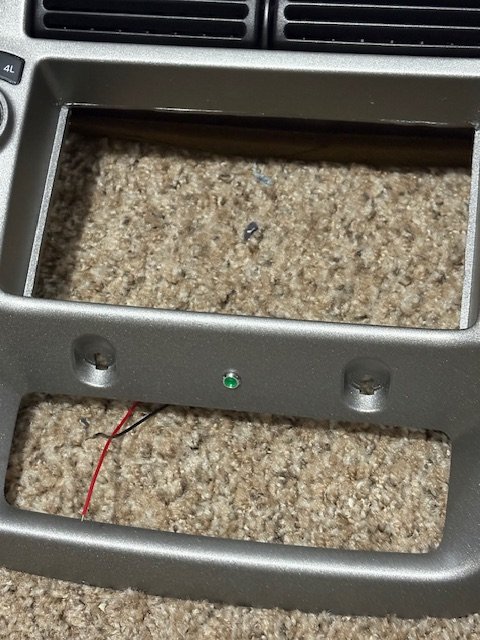

Moving slowly due to a health issue but, making progress. I finished the sound deadening. I decided to just do everything inside. I painted the radio bezel and the HVAC knobs a silver-metalic that is close to stock but with no gray. I put an LED in the radio bezel just above where the HVAC knobs will be. I have yet to install LED's in the driver and passenger footwells as courtesy lights and an LED in the glove box connected to a micro switch. I also decided to put in a new carpet. Then I can start putting it all back together!
