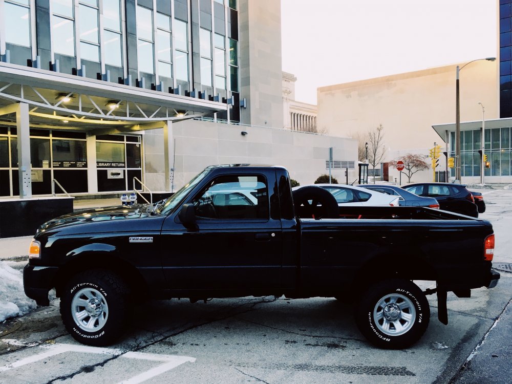

After checking the upcoming weather, finally felt safe taking the Blizzaks off and putting my summer setup on. Watch as we get a blizzard or an ice storm or some shit like that in Wisconsin next week, haha. ? Anyways, my truck is a 2010 2wd XLT - stock size was 225/70r15, this is 235/75r15 with a 3" body lift and Firestone Ride-rite air springs in the back. I was on the fence about doing 31s since I know BFG is known for undersizing. These definitely seem noticeably smaller than the Blizzaks in the same size, which I was not expecting. Oh well. I don't dislike the look, it's definitely proportional and looks OEM in a retro kinda way that reminds me of the OEM , but I could've at least gone with 30X9.5 and probably will do that next time. Still feels well within the power band of the 2.3 in this size, though, so that's good. Now i just need to drill/tap the wheels so I can put my old-school Bronco II center caps with the split red center on to complete the retro rally wheel look. ??
One thing I can say is I'm surprised how civilized the truck feels with these on. I had these tires in 31x10.5r15 on my 1st gen Tacoma, and that truck rode like a dump truck with those tires. I loved that truck but man one thing I've really come to appreciate about the Ranger is that, even in a configuration that shouldn't ride well, it's pretty comfortable. Either way, it's given me a different outlook on these tires. They'll be easy to live with. Can't wait to take this thing on some logging roads. Not sure how deep I want to get modding this truck since i was planning on keeping it stock-ish for a daily driver, but, a locker might have to be my next move.

Looks good. I plan on doing 235/75r15s on my 09 2wd this spring when I need new rubber.
I’ve got these tires on Alcoa rims. I had the 31’s. I’m glad I went back to the XLT Ranger stock size. I use them year round, though. Sometimes I think I’d rather have a smoother tread, Firestone or Michelin tire.
Best damn tire you can get.
Honestly pry wouldnt even need those blizzaks.

Yeah. All the bros on the facebook Ranger page were giving me shit about not going with 33s, but having been there/done that, at this point keeping the unsprung weight reasonable and not accepting a new clutch every 40k as a fact of life are bigger considerations than they would have been a decade ago, lol. Plus I'm not planning on doing anything more hardcore than fire roads and logging roads, so it's not like I have much to gain other than looks (subjective since I actually like the stock look) by going bigger.
And, I agree, these are great. My guess is they're as good/better than the Blizzaks in the deep stuff, but ice and light dusty/slick snow is the one place where the Blizzaks beat them.
