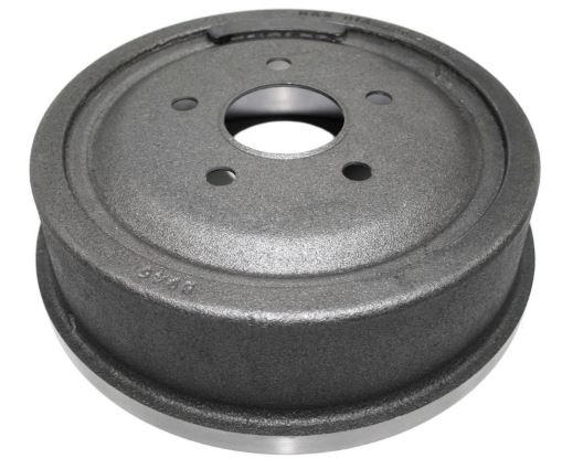

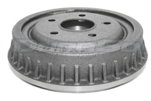

They are very different, visually.
9" drum
10" drum

The easiest way to identify which brake drums you have is if the exterior of the drum is smooth or ribbed. Smooth, 10". Ribbed, 9".
