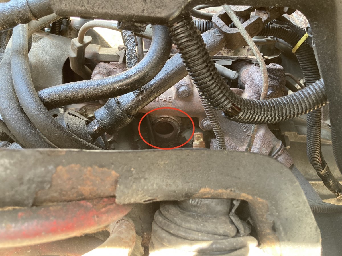

Something(s) missing here?
This is peaking in from the left front wheel well. The lift makes this nice and easy to see things.
There are at least two large holes sitting open down there, which is the drivers side of the engine. There is also some kind of unmounted bracket point which i also circled.

.....are you missing an entire freeze plug?
Photos unclear.
It's quite tough to get a good shot of, but here's a pic that shows both big holes together.
I can't see this section of the engine from any other angle unfortunately. Hence i didn't catch it until i was looking inside the well for some other stuff.
On the note of freeze plugs, here's a video that seems to be quite related. I can only see two open spots in my engine but perhaps there are more. Looks like a nightmare to try and plug them with the engine installed. Why, and how, would someone remove these?

If the freeze plug was missing you would also have no coolant in the engine.
Apparently some people say you can still run it you just have to keep the coolant level constantly topped off. My truck's coolant level is good. It's not healthy and needs to be flushed, but it's at a good level. This makes this all a little weird. I've noticed no leaks of any sort.
I don’t think thats a freeze plug hole, judging by the images in that video.
There are often extra holes and extra threaded holes in castings like that. Could be mounting points for optional equipment or for using that engine in other vehicles, earlier versions, etc. If it’s not leaking something from the hole, it’s not likely a problem.
