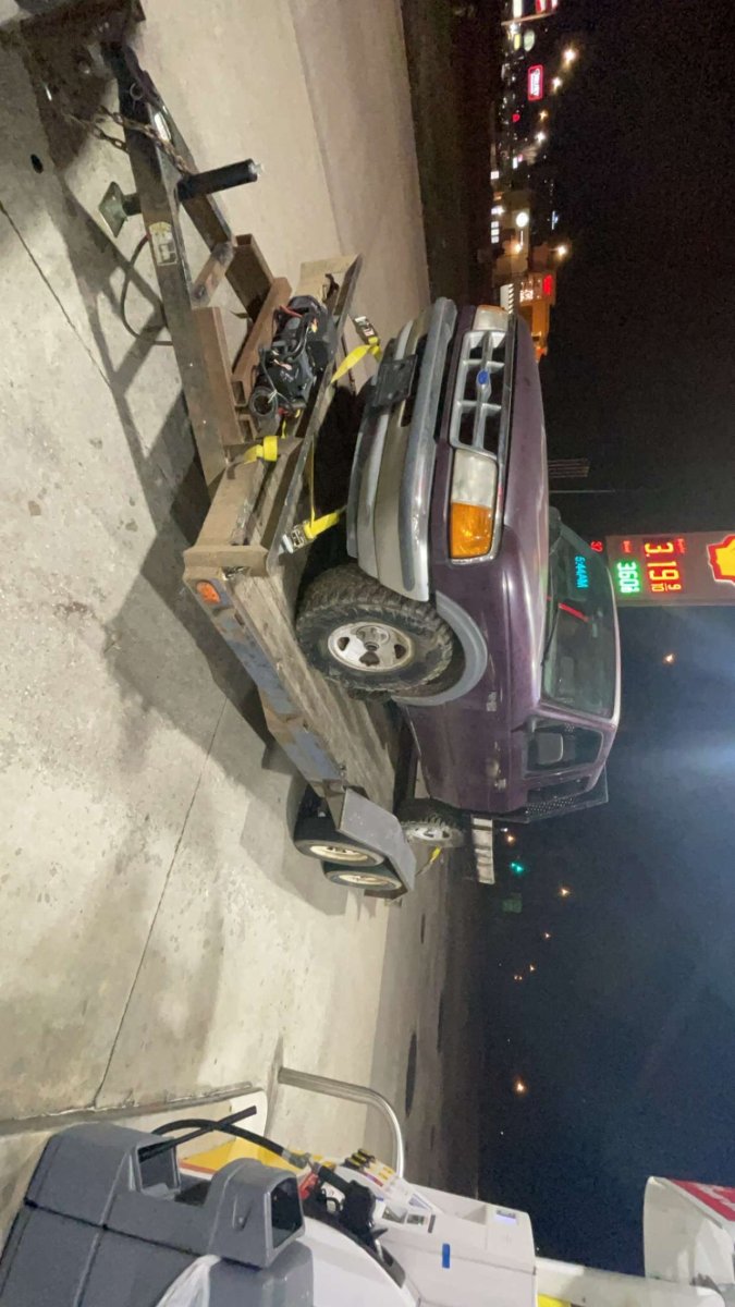

I brought home a 94 extended cab with a 4.0 and auto. I’m up in the air what I’ll do with it currently, atleast till I figure out the problem. The transmission kinda works, it goes into reverse just fine but to go forward it has to be warmed up some. Fluid level looks good but didn’t smell very strong like atf. Should I start with a fluid and filter change or is there something else worth looking at in addition? I figure worse case I’ll use the truck for parts for my main ranger and maybe repower it eventually with something else

I feel like there aren't enough details to make much of a suggestion. The 94 looks pretty good to me from that 1 pic. I'd probably try to save it since it runs. When you did the 01 frame for the 95, what did you use for the front suspension? What are you looking to end up with?

Try adjusting the bands on the auto transmission, they’re supposed to be adjusted regularly but they’re probably still in the same position it left the factory in…
Also, I’d do a shift kit and valve body work if you change fluid and filter…
