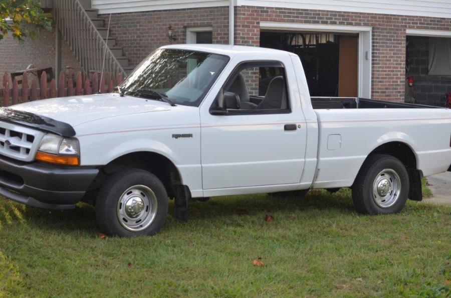

Greetings -
We just purchased a 1999 single cab Ford Ranger for our son's first vehicle. The truck has 80K miles and a 4 cyl 2.5 liter engine with an automatic transmission.
We had the truck inspected prior to purchase and two issues were identified. Bad ball joints and an intermittent ABS light. Since purchase we had the upper and lower ball joints replaced and while we were at it we had the timing belt changed and the water pump replaced.
We have not tackled the ABS light issue to date. The brakes seem to be fine. The mechanic that replaced the ball joints / timing belt seems to believe it is a faulty indicator. The dealership recommends the replacement of the control box which is about a $500 repair.
I considered have the local repair shop replace the ABS module but the say the replacement of the ABS module requires special equipment to reprogram for this unit.
Does that seem correct to you guys? Does this effectively eliminate the solution of used a control module from a junk yard vehicle?
Thanks for any thoughts!
