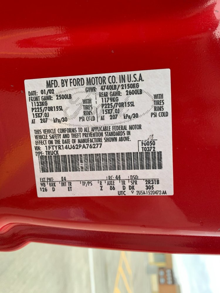

Hey guys, just bought a super clean 2wd red XLT with 98k on it (absolutely jazzed about it) and I plan on making it look a bit more aggressive by installing new rims/tires, grill, bumper etc.
Here she is.
First things first I want to think about wheels so that I can plan for a suspension lift. I don't need anything CRAZY but I want them to look meaner than stock ya know?
My friend recommended K02's and Wildpeaks for tires. However I am an absolute noob as far as understanding rim/tire sizes and what would be compatible with my vehicle. Where do I start ? What do I need to understand before I dive into this? Can I upgrade the rims / tires prior to doing the lift?
Please give me some direction / articles or any other resource you know of to help make things a bit more clear.
Thanks in advance!

3.73 to 4.10 isn't a big jump or worth the cost IMHO. Frankly it would be easier and cheaper to go to a junkyard and get the rear out of a 4wd that already has a 4.10 limited-slip in it. 2wd lifts cost less too, some blocks on the rear and dropped spindles in the front. Tires up to 31x10.50-15 would be fine and look good on a 15x8 wheel with 3.75" backspace.

If it were me, for right now, I would look at the 235/75R15 or perhaps the 30x9.5x15 at the largest, if you were willing to upgrade the axle or do a small lift relatively soon.
