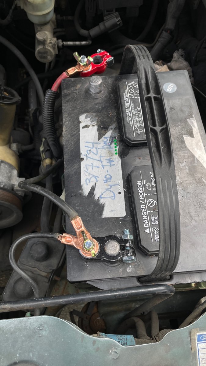

HI, I have been having problems starting / battery drainage with my 95 Ranger. I bought it new and it has been a great work truck for my sheet metal shop. Been driving it less, of late, and lately have replaced the battery terminal clamps because it won't start and I get the clicking sound. Solenoid ? Shine up the wire ends and reclamp and then it starts. Until a couple days later when it won't start. Just now checking if the charge I'm putting on it will hold. The last time I jumped it with our car, and when I took off the charge cables it started to run rough, sputtering like it was flooding...actually giving it a tap on the gas pedal and it still died. Then Nothing when trying to restart without jump. I just put on a pair of marine style connectors to the battery, so I could put crimped copper wire connectors on the pair of wires for each terminal, and hold them on with wing nuts. Thanks for any advice, Doug. I did check the 15 Amp fuses mentioned

Definitely a voltage issue. Could you post a picture of your battery connections? They need to be clean and tight. As mentioned above, corrosion can get back down into the cables and destroy them. With bad connections (positive or negative) you are guaranteed to have starting issues and charging issues.
I second the recommendation to disconnect the battery and charge it overnight with a decent battery charger. Then, once we know the battery is charged and connections are good, we can start taking voltage measurements and diagnose any other problems with the alternator, starting relay or starter motor.

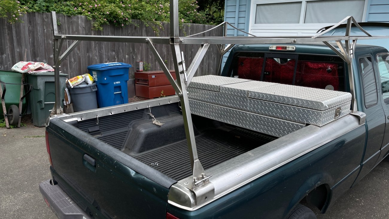

I charged the battery overnight, put it back in the truck and it fired right up. The new cable ends look fine, tho I had to modify a sheet metal air tool to crimp them, not enough hand grip strength to do that manually. (and nothing else to use with long enough handles.) The terminal clamps seem very flimsy, it's hard not to overtighten them when I'm wondering if they're getting a good connection. I do like the wing nut action on the marine style clamps. So, it looks like the alternator is funky. And that could also be the source of a high pitched whine that's been happening when it gets good and warmed up. The best thing I ever did with this truck was to put on a stainless rack and bed rail caps. I went through a couple of steel racks, tried to keep them painted and unrusted in rainy Seattle, a losing battle. Every time I threw another extension ladder on, the paint would go flying. Powder coating was worse. The rail caps are 18 ga stainless. I couldn't bend that myself, so I had another shop do it, and I made and welded in the end caps. It all looks exactly the same 20 years later. I tie off to the snap hooks all the time with loads that aren't tall enough to fix to the rack. And I love using the cleats for marine style tie offs, so quick and easy and reliable. And I re-bend the hooks on bungee cords so they drop securely on the 1" square (16 ga.) rack. The ding in the tailgate always reminds me - don't back UP with the tailgate DOWN. D
