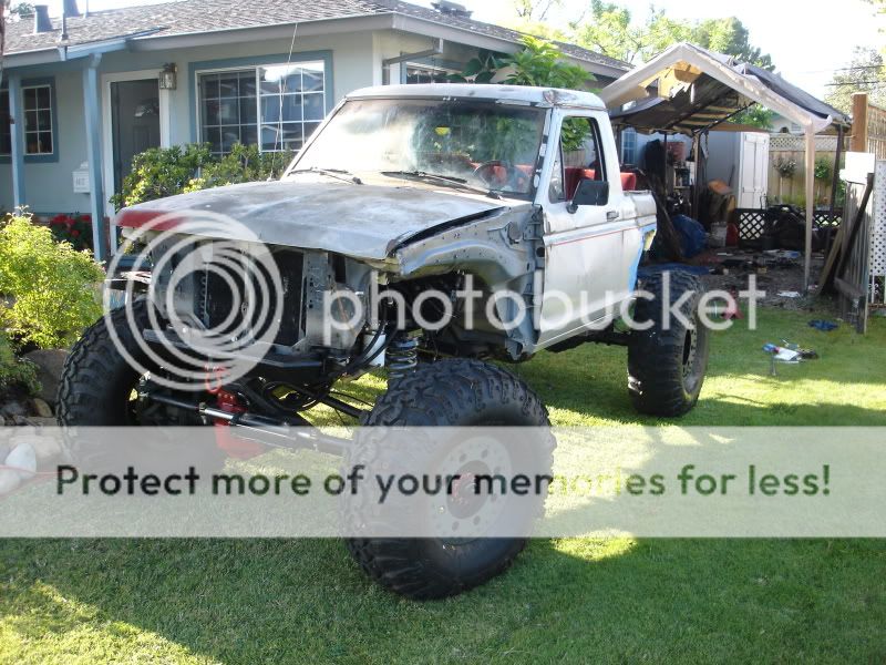

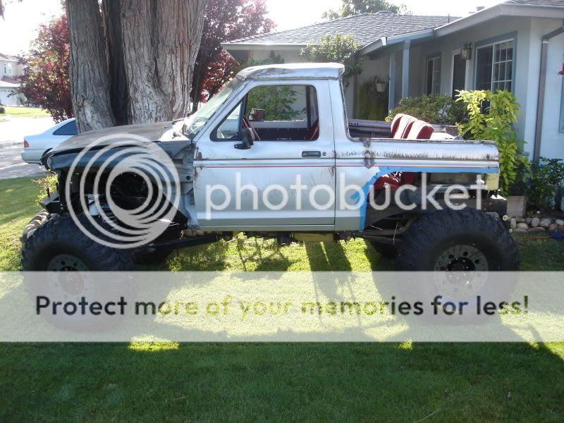

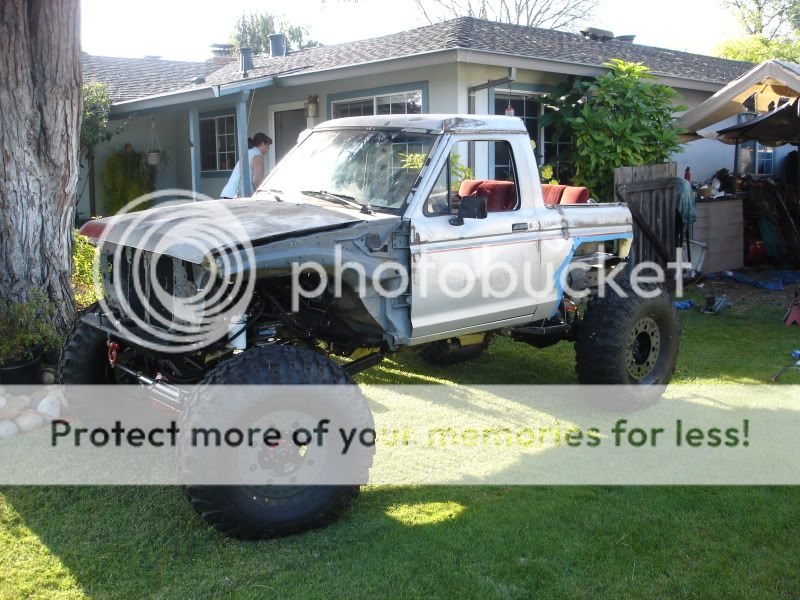

Well I got around to a test drive yesterday. Overall im pretty pleased. Heres what the truck looks like free from the side of the house:

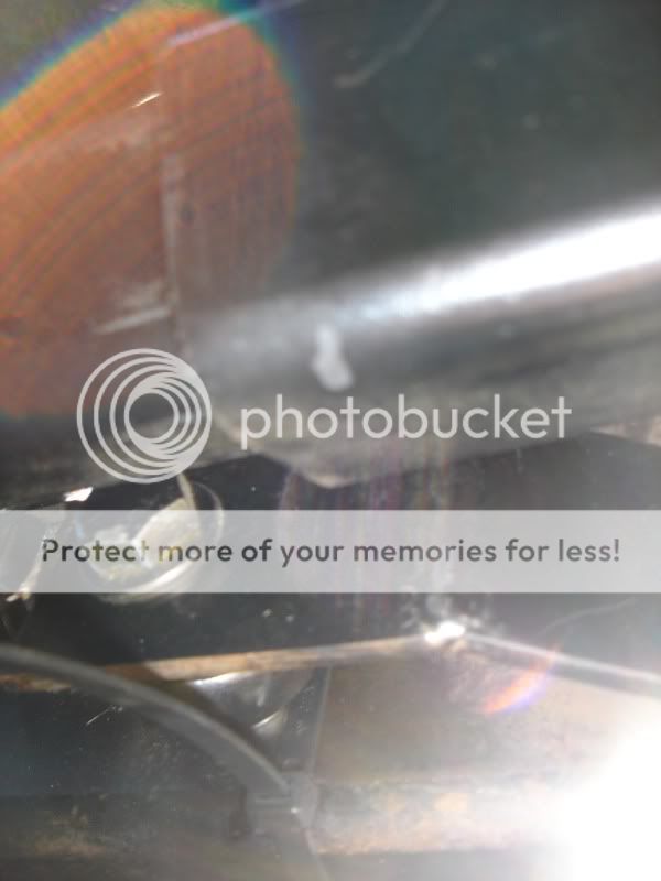

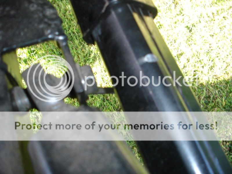

-when I slam the brakes, there was a really bad (and LOUD) grinding noise. Turns out that my driveshaft didn’t have enough clearance from my passenger side radius arm. When the suspension compressed from braking, it hit in a few places. Here are the pictures:

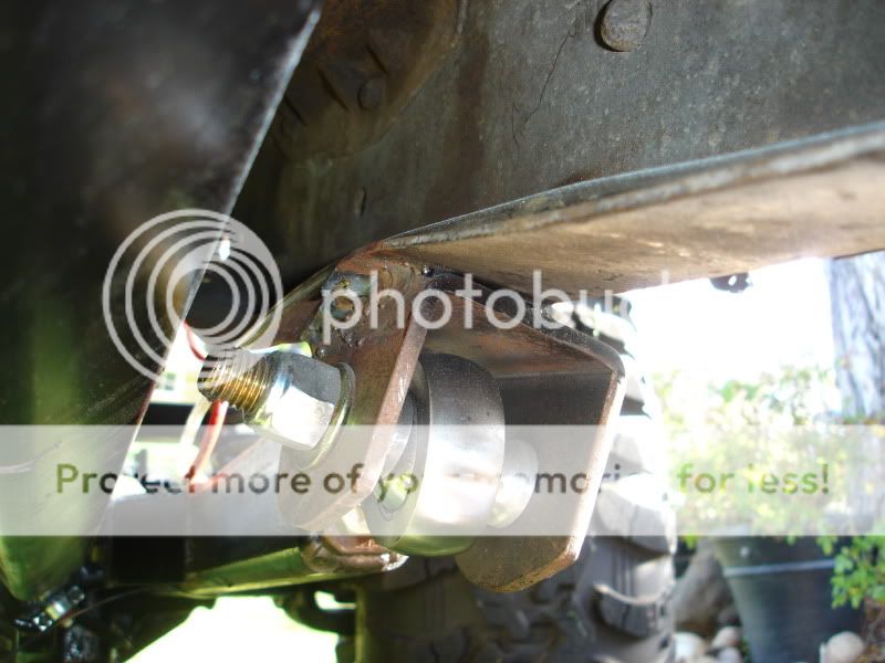

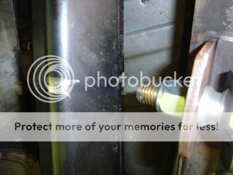

which did this:
New guy, new project: 1988 BII wheeler
the heim and bolt are supposed to be perpendicular… The frame bent up about ½”. My weld held up just fine though. Also reminds me that I MUST box the frame haha.

turn the bolt around that hit the drive shaft, should clear then.
Robert
nice work.
Robert
Hey thanks alot for the suggestion. I was looking at that but think if i did that i would have to remove the driveshaft if i wanted to take out that bolt. I think im just gonna cut off the excess threaded portion and that should do

you might also want to check your panhard(sp) bar, try to get it level as possible if it is leaning down too much, what is happening is when you hit the brakes, and the suspension loads up, it is pushing the axle over to one side.
