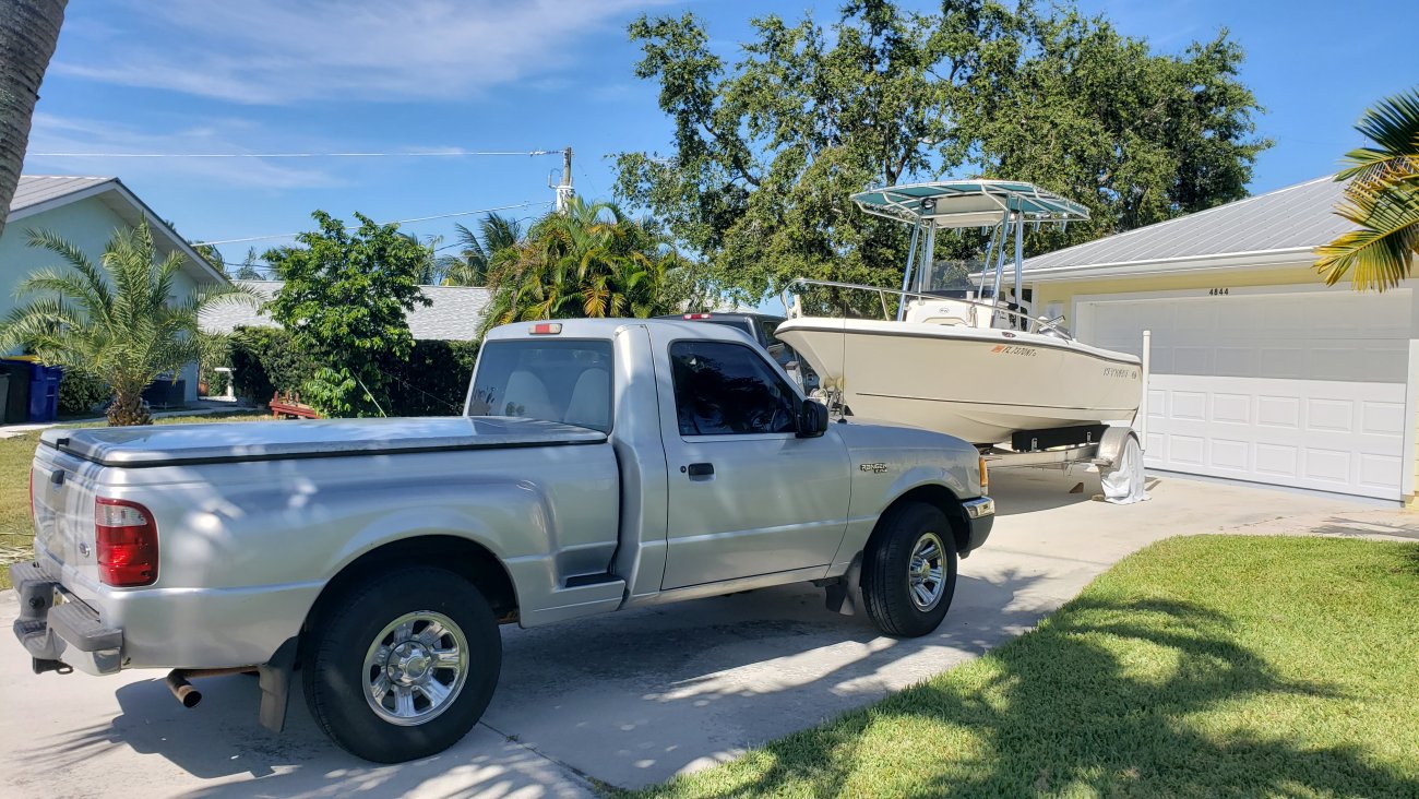

New guy in Florida. 2001 Ranger Step side. Bought in 2008 in Texas. Moved her to Florida. Then gave her to son in Alabama, she visited him for 7 years. She's back with us again in Florida. Wife loved the little truck.
Used her to tow our little 19' Key West for about a year or two. Kind of thought that might have been a little too much, but the Ranger did fine. Never failed to jerk that 3200 lb boat right out of the launch.
