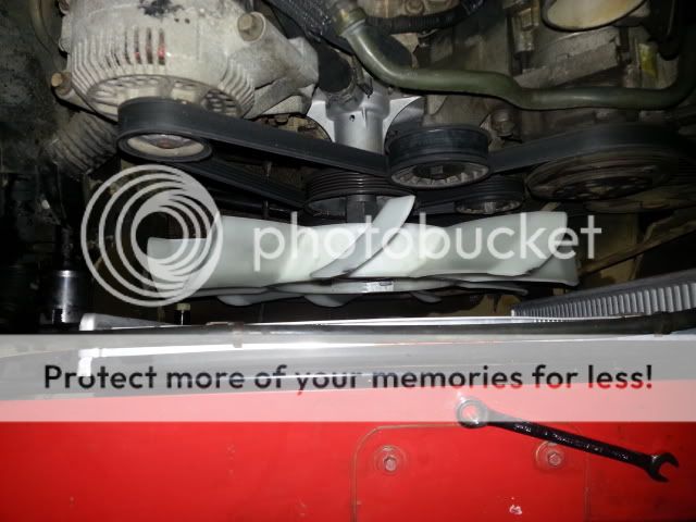

ok, so after hours upon hours of fighting with this, I noticed something that I should have seen a long time ago. the fan is the opposite rotation than what it should be. Looking front of the vehicle, the motor rotates clockwise.
After days of internet searching and calling parts stores and dealers, I decided to just convert to an electric fan. The dealer wanted $150 for an 8 blade clutch fan (I have a 9 blade on here now BTW). I picked up an e-fan and wiring kit for $65. Seems to make sense to me.
This truck is a daily driver (DD) and I sit in traffic for 2 hours a day and don't have time to be nickel and dimeing this problem. That is why I just threw everything at it at once. And I'm glad I did. The whole cooling system was all rusted out and clogged up.
The e-fan will be going in today and I'm going to be stumped if this doesn't work. Back flushed the block and cleared everything out. I know the flow is good and everything else is new.

OK! So, I changed out the clutch fan for an electric fan yesterday. While I was in there I changed the shocks and spark plugs. Ran her around today and she is smooth as silk!! A/C and everything works without any problems! Now the real test will be sitting in traffic for 2 hours!
