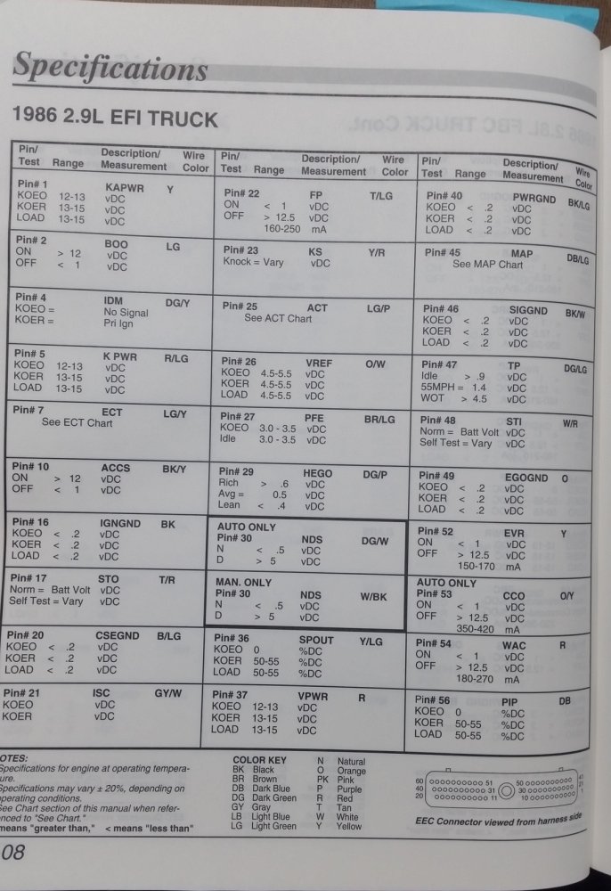

Just a quick follow up.
I bought the computer from the junkyard that I described up top. Plugged it in, through some fuel in and started up quick and runs fairly well (Sat for a few years and runs as well as I remember it). When I got it, I compared it to my old computer and noticed the pins didn't match at all. It turned out that the new computer had all the pins my computer had plus extras mine didnt.
Just for my own curiosity, does anyone know where I might be able to find a pinout diagram for the ecu? The only ones I've been able to find have been for 1990+ or for a 4 cylinder. Nothing for a 1986-1988 2.9.

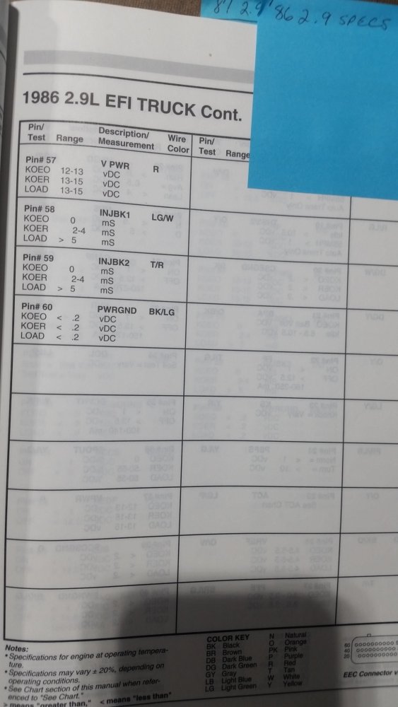

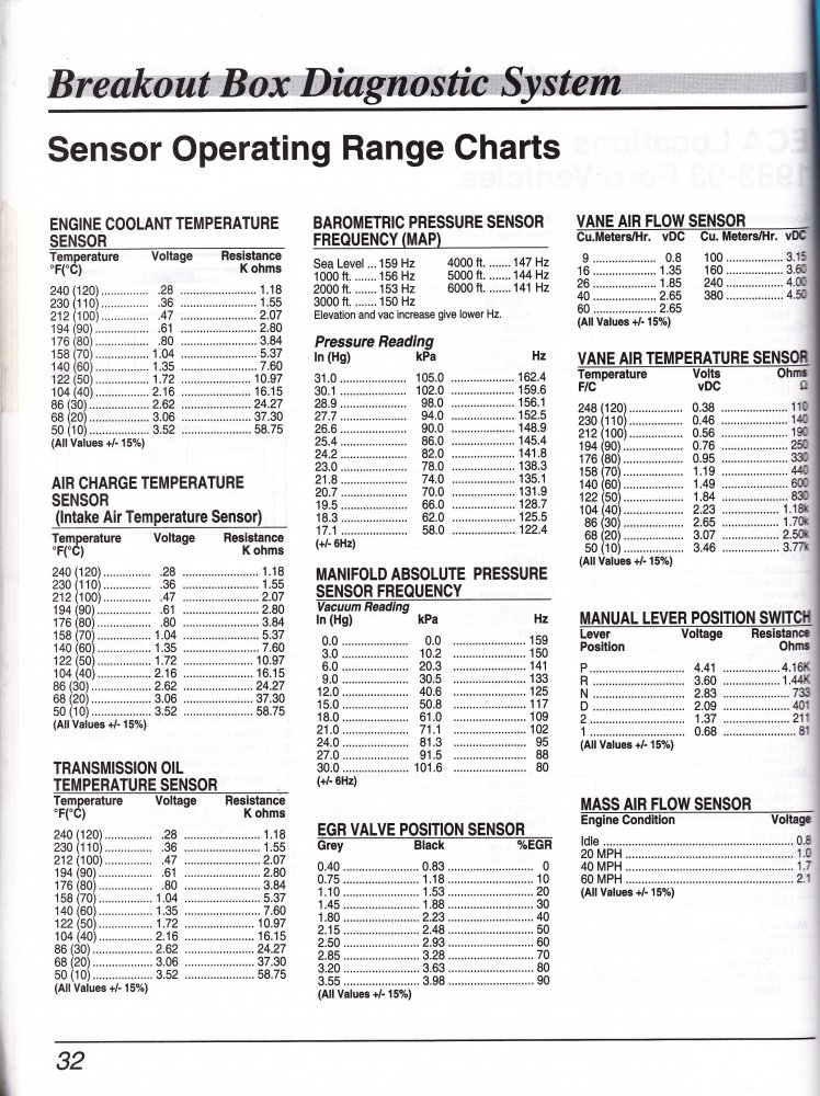

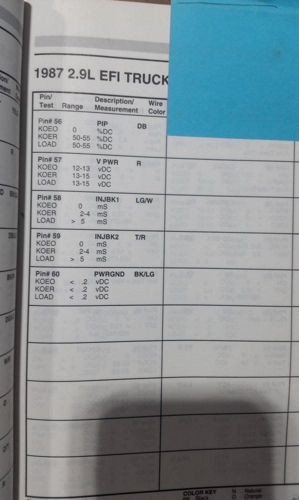

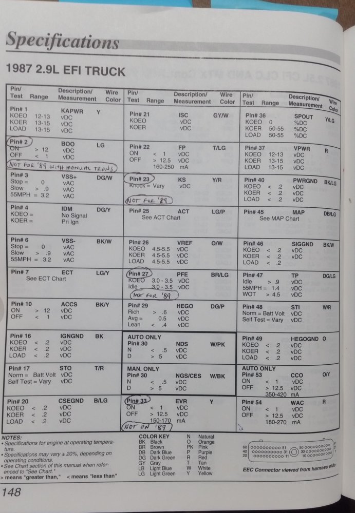

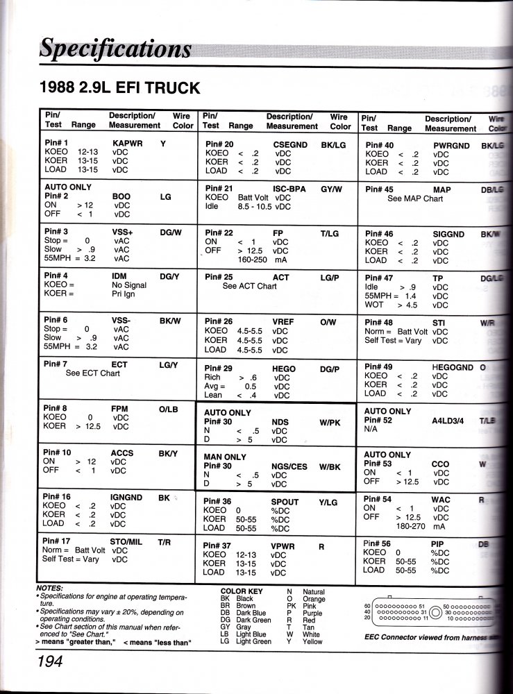

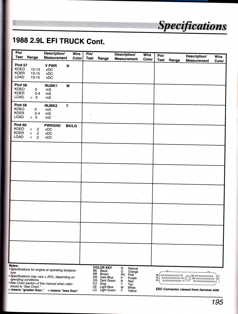

Here's '86 through '88 from the UB-80 Breakout Box Manual, with the Sensor Operating Range Charts. I'm interested to know if these differ from what @PetroleumJunkie412 has.
