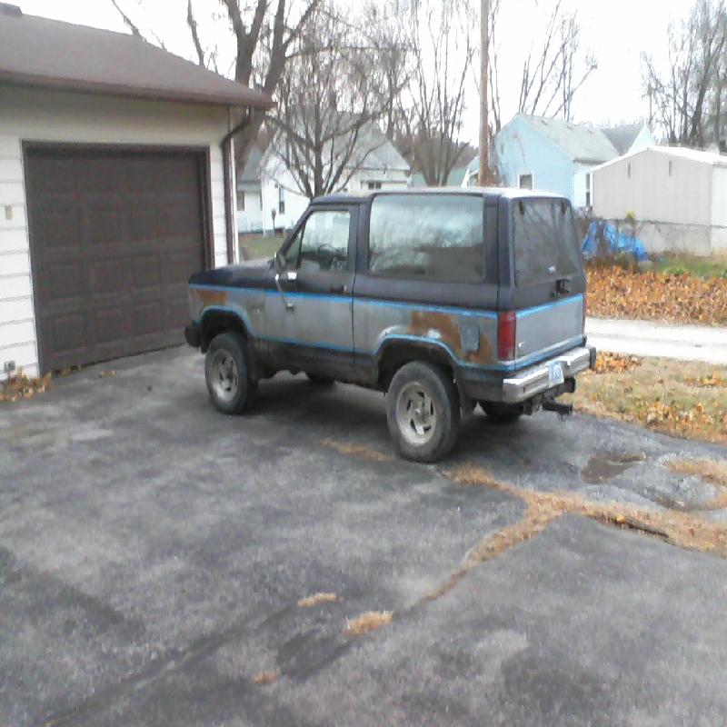

At long last. It has made the journey home. Was a little sketchy, but now I get to go through it, inside and out. I'm sure a large part of it is that it hasn't been driven for just shy of a decade.
Sorry for the craptastic picture quality. I run a cheap phone with a crap camera. I will eventually get better pictures up with a normal camera.
Much thanks to Ruffinit for the help!

The lovely mouse infested interior has been cleaned up a little. I have to remove the carpet and everything else to discern how many holes I have in the floors. There are a couple in the "bed", and around the drain plug for the rear seat, rust has become a problem. Also, at least on the passenger side, where the body mounts to the frame, the body has started to rust through. I managed to stick my knife through the hole into the carpet from underneath.
I'd like to think that this is something that could be fixed with relative ease. I'd rather not find a new body to set on it, but I will if I have to.
(Suggestions are gladly accepted)
