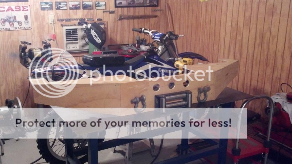

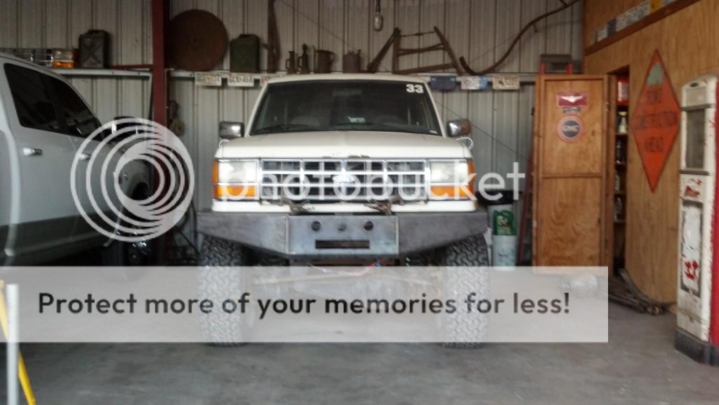

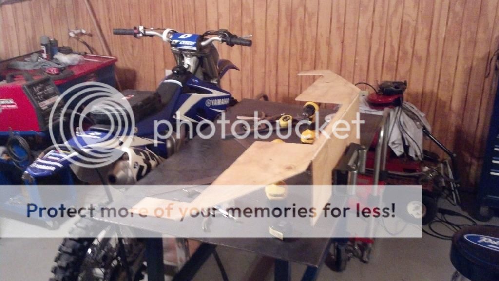

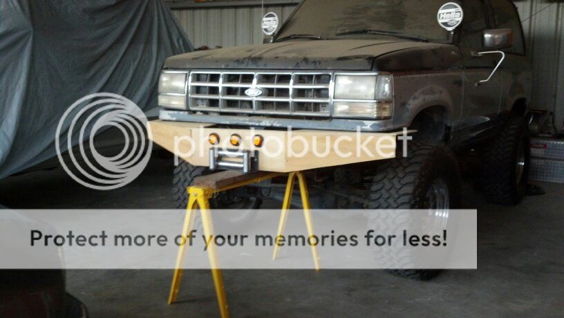

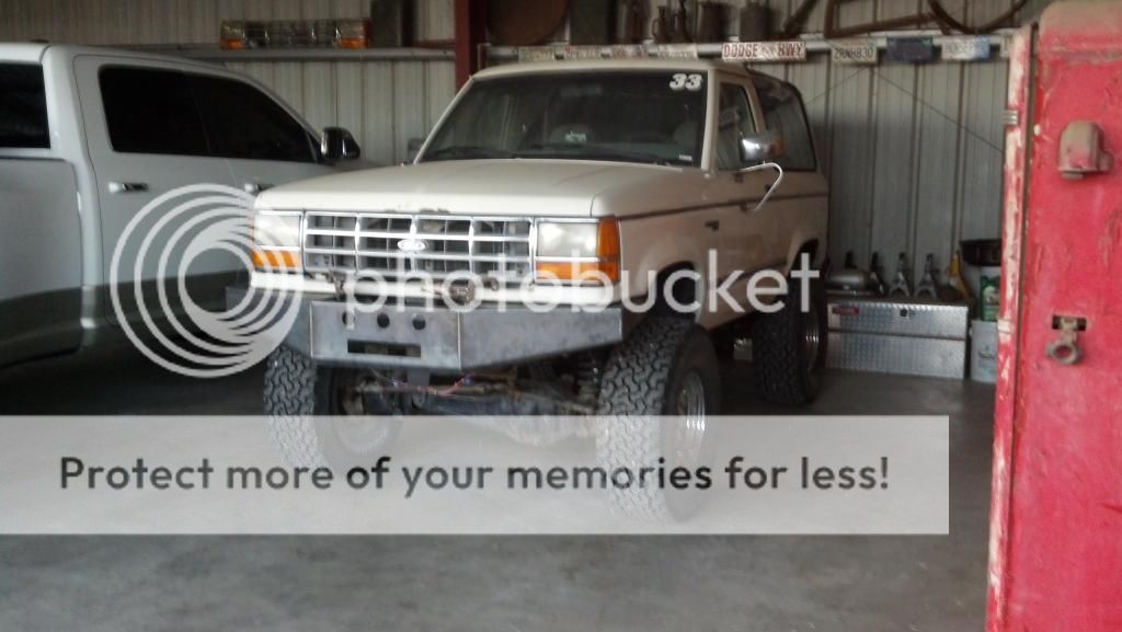

Finally got around to putting some pictures of my bumper I just build. Work in progress. Still have more work to do, but the idea is there..
I like that you made a master of wood first, that would save a lot of potential problems as well as letting you see the esthetics. Did you use 1/4" or 3/16"?
Richard
Looks good.
Only thing ill say is..
Make sure to have drain holes down in your winch area....
LOL, I know I spend so much time on the wood one, I hate to throw it away now. I was going to use 1/4 but went with 3/16, it was easier to work with and to do the return on the bottom. I have to make a bar hoop and some mounting brackets still. Been to hot in the shop to work, 100 everyday. Hopfully get back to it soon.

the first bronco with the templet is a different bronco right

Bumper looks great man. Not trying to get off topic but what did you use to mount your hella lights up on the hood like that, would love to do that to mine
