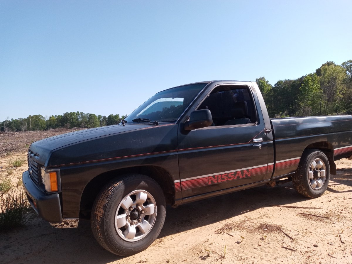

Drove my Little Nissan 604 miles to Arkansas to swap trucks with my dad.
I got a problematic 98 F-150 XLT and an old "Honda 300" 4-wheeler.
New 2 me F-150
He received trouble free 88 Nissan D21.
New 2 me F-150
Although the F-150 is 10 years younger, it has almost the same amount of miles as the D21 ( 208k on the 150 vs 240k on the D21 )
The F-150 will be my "new" weekend warrior, not a daily driver.

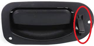

So, it has a 3rd door I never knew about but I can't seem to get it open. Anybody know anything about that?
Yes... you open the front door, pull the handle on the rear door, and like magic the rear door opens.
If it doesn’t open, either the cable or one of the latches is messed up. It has 1 at the top and 1 at the bottom... The bottom one usually gets rusty and sticks, then the cable end breaks.
i have read the cables are huge issues on those rear doors
There is a goofy little lever at the top of the handle that pokes out. I can feel it moving something.

Almost like it was locked when the cable snapped or something. How do I get in there to see .
Check the child lock.
There is no child lock on the supercab because you can’t open the suicide door without opening the front door first.
Do you know anything about the lever I circled in the pic ( post#11)
I think that locks the door handle from being able to move when the front door is closed... I have a few trucks here, I’ll check in a little while.
