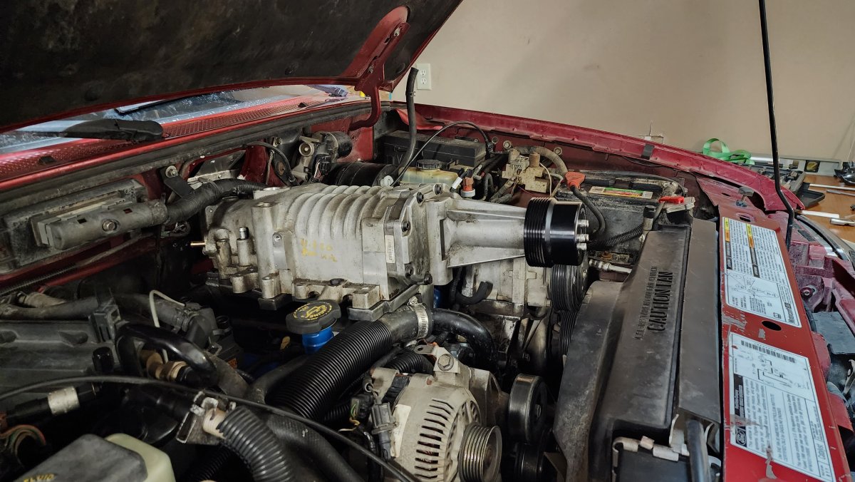

M90 - You can run them with stock injectors and pulley sizing. Anything above that will likely require stronger injectors. Tuning will always improve the performance, but is not required. The M90 Gen V pictured above is off a GTP. It requires a 1" offset pulley and small modification to the firewall/cowl. I would recommend one of the shorter styles.
You can swap the shorter snout from the other GM M90 and then you have plenty of room, except it tends to put the blower too far forward on the engine.

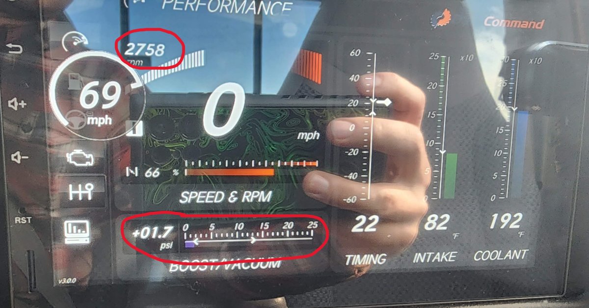

Another update: Went down to a 3.4 pulley and got this:
Almost 2lbs of boost at 2700RPM. I finally found a shop here that will make me a 3.15 pulley via CNC. That should get me to the 3-4lbs range at 3000RPM.
That seems too low of boost for the size pulley you have. What did the rotors look like on that blower before you installed it?
The rotors are in great condition. That is the correct boost level. Keep in mind:
  • The stock pulley on a GM M90 was a 3.8 w/ a 7" harmonic balancer. That equates to ~1.82 ratio.
  • The same setup on a Ford 4.0L w/ a 6" harmonic balancer equates to ~1.51 ratio.
  • Getting to the 1.82 ratio on the 4.0L requires ~3.2 pulley.
  • The GM 3800 easily went 4-5k rpm. I never go over 3k rpm with my 4.0l, so I want boost coming on at lower RPM. Hence the 3.1-3.2 pulley I am having fabricated.
