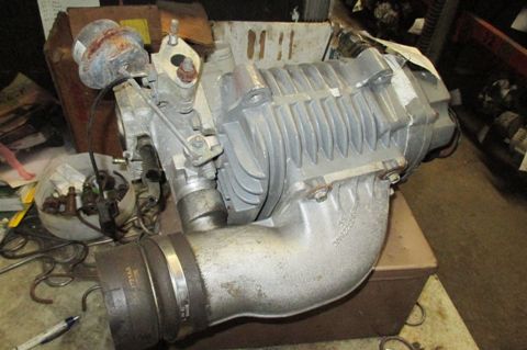

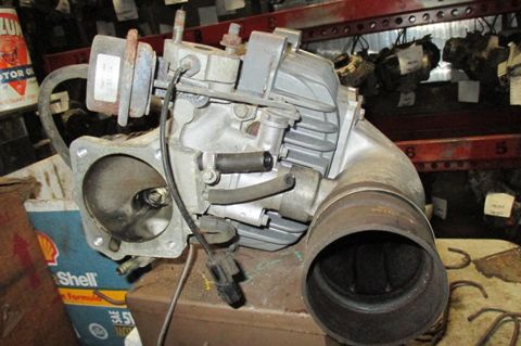

another option is an m90 out of an 95-97 jaguar xjr, may be other years not sure. shorter snout if that helps you. this is basically what i have, but i have yet to install it. i don't have factory a/c, so i'm trying to find a way to intercool with this setup. they are usually a bit more money.

I have a pair of Eaton M90's sitting here, one out of an '89 Cougar and the other?, I've always thought an M62 off of a GM would be a better match for the 4.0OHV, but I can see underdriving the M90...

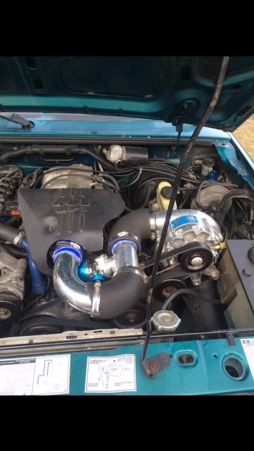

Vortech.
1992 Ford ranger xlt 4.0l ohv
With current pulley seeing 3lbs boost!
Runs great! The piping in picture is just mock up... Waiting for proper peices!
Stock injectors stock maf
Vortech v1 s-trim
Vortech 12:1 fmu
eBay bov
Aem wideband
Digital boost gauge
255 walbro pump
Spec stage 2 clutch!
No check engine, pulls hard, no tune!
Only thing is I'm surging a little at idle, and running really rich at idle!
Driving is great tho!

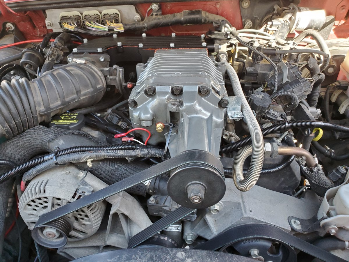

Hey guys. I have a 96 4wd single cab with a 4L and Auto. I ran across this video with an M-62 Eaton install.
I have a M-90 off of a 2002 Pontiac Grand Prix GTP. Does anyone sharper than me know if all the sensor swaps included in the above video will work on the M-90? I know the Intake and throttle body are on the drivers side on the M-90, but am unaware of other differences. What are you guys doing for upper plenum/supercharger adaptors? Just cutting a stock upper intake above the flange, and welding on a short plenum box/supercharger adaptor plate? Doesn't seem too hard to do.

That's my truck and my video, haha. I've done a write up on the whole thing in this sub forum, let me know if you've got any questions. I know the 4.0 heads are a weak point and that sounds like sound advice to me (care to do some pro bono machine work?) and I may do that in the future should I ever run into issues with the setup

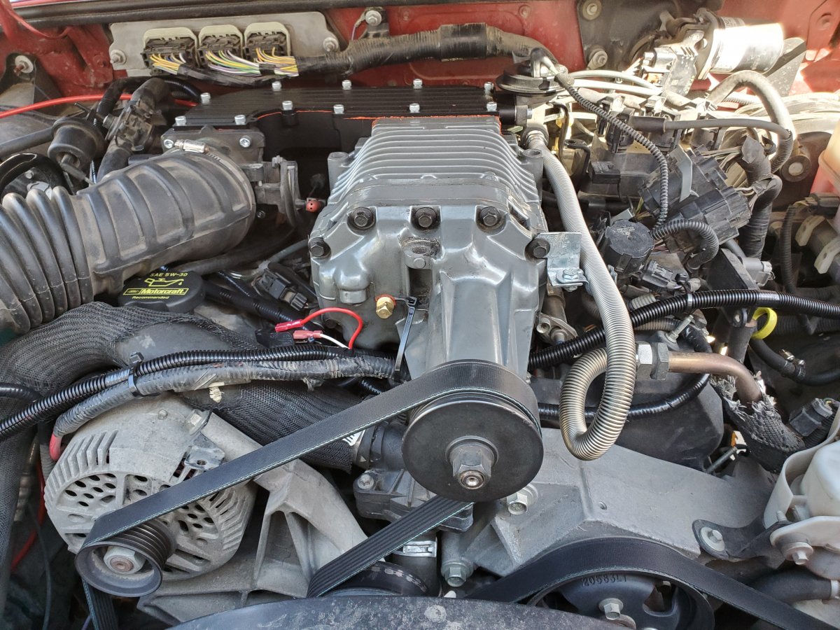

I put the Moddbox kit on my 09 FX4 this fall.
69626
Overall, the kit is well designed and well executed, and the instructions are pretty clear in most respects.
There are a couple of details that I think they should have addressed:
1. Using the Ranger EGR valve results in the extension tube pushing on the coil packs. I fixed this by obtaining a Mustang EGR valve (as shown in the photo) which has the intake port oriented to the front rather than to the driver side.
2. The throttle body is about half an inch farther to the passenger side of the vehicle than it needs to be. This results in the tps sensor being smashed up against the heater core hose (you can see that in the photo) and the iac being right up against the heater housing (hidden in the photo). This will make r/r of either of those parts fairly complex as the whole intake to the blower needs to be removed to access either. Their instructions do not clearly state that the electrical connector must be on the iac before you install the intake piece, so I got to do that part twice.
3. The air intake hose runs right over the oil inlet. This is not a huge issue for me since my engine thankfully does not use oil, so I can take the intake hose loose a couple of times a year when I change oil, but if the throttle body were angled as suggested in one of the posts above, that could be avoided.
Given the complexity of the whole system, those are fairly minor concerns and overall I give it an A- for design and execution. I had the RPCaster kit on my 03 FX4 back 15 years ago or so, and this is much cleaner and better executed imho, and it appears it will provide more power for the same boost level due to smoother flowing air into and out of the blower.
The pully I have on the blower generates 6 psi boost here at 5000-6000 feet elevation, and it makes a pretty significant difference in performance. The truck was kind of a slug in factory trim given the lack of air up here, and with the blower its perfectly adequate, but will only feel like a race car compared to a 3.0 Ranger. I tune with SCT ProRacer and am still working on the tune - I don't have the meth injection turned on yet but here at my elevation there is not much adjustment to the factory tune required even at these boost levels. I do have the iat sensor relocated to after the blower, so I can make the tune sense if the meth injection is working or not and adjust accordingly.
