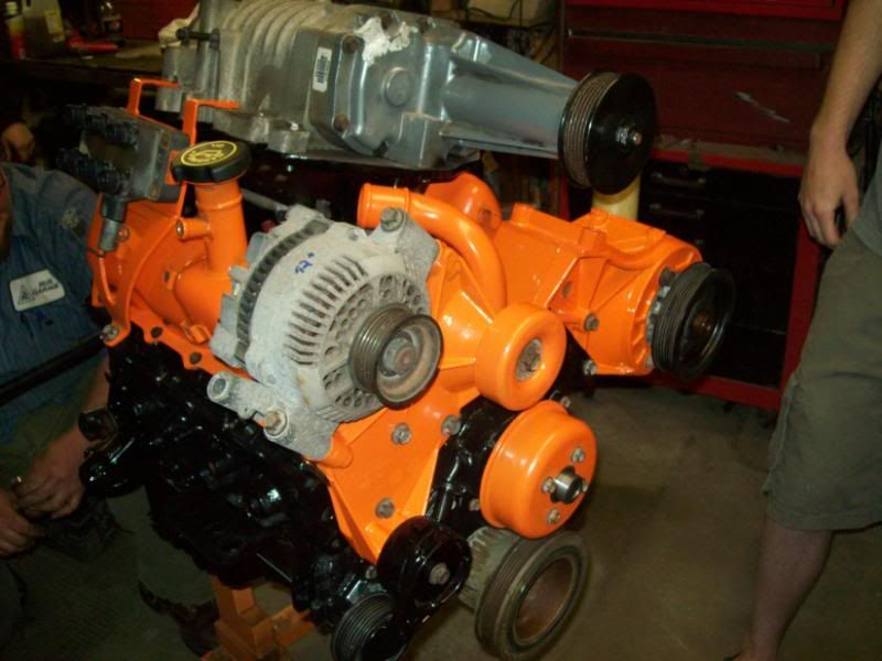

I do not have experience with the GM version of the M90, but I have over 10k miles on my Moddbox conversion on the 09, and I had a 03 Ranger that I put the rpcaster supercharger kit on and drove it at least 50k miles before selling it. Both of those kits use the T-Bird M90. In both cases I changed out the input shaft seals and the drive coupler, and put in new oil in the blower. Those blowers are very reliable and last for a very long time, and I have had zero issues with either of them.
I have probably put 3000 miles on my M62 pushing 5-7psi. Over 1000 miles of that being VERY abusive offroading. I will say, heat is a huge problem. Truck runs 210* and climbs to 230* really quick with any abuse. I have tried everything from no thermostat, to 3/4" orifice, to 160*, 180* and 195*. I have tried E-Fans, stock plastic tank rad and now a full aluminum rad with a factory mech fan with "severe duty" clutch. I used to run an oil cooler through automatic trans cooler portion of the rad too.
Currently the factory fan, shroud and no oil cooler is doing best. I will likely add a remotely mounted external oil cooler with an E-fan later. My next build will have no AC and potentially a rear mounted radiator.

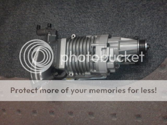

It depends on the supercharger being used. I would not go lower than an M90 (90CFM). Those were made for 3.8L; so close to the 4.0L size. You can run a smaller blower, like an M62, but you'll be spinning it pretty hard. You can can also go bigger, like an M112 or M122; which will need stronger injectors.

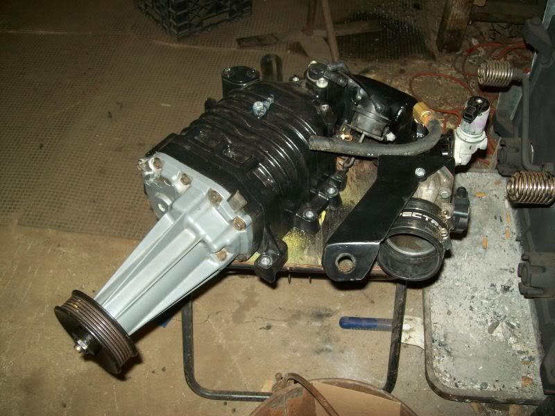

M90 - You can run them with stock injectors and pulley sizing. Anything above that will likely require stronger injectors. Tuning will always improve the performance, but is not required. The M90 Gen V pictured above is off a GTP. It requires a 1" offset pulley and small modification to the firewall/cowl. I would recommend one of the shorter styles.
You can swap the shorter snout from the other GM M90 and then you have plenty of room, except it tends to put the blower too far forward on the engine.
