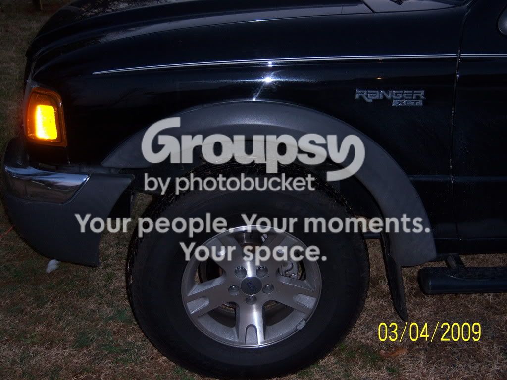

This is a pic of my truck
Here's a close up of the wheel.

It looks to have a B/L and a Superlift, so my guess is 35x12.50's and they're definitely on 10'' wide wheels.
You have the stock 16x7 wheels. A 33" tire to go on that wheel would be a 285/75-16. A tire wider than that and you should get an 8" or 10" wide wheel.
Whats the biggest tire that would fit on there without a lift? 265? 285?
265 with no lift. A 285 will fit with a torsion twist. I'd stick with 265's though, the 7" rim really isn't wide enough for a 285.
I have a set of older aluminum rims with 285s on them, (7in wide) so they are not to narrow of a rim.
I didn't mean they wouldn't fit, just that 285's are better on an 8" rim.
