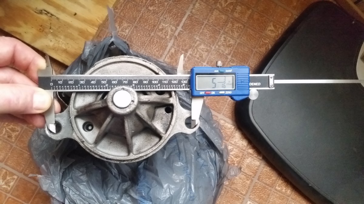

The bolt holes in a 2.9 starter are approximately 5-3/16" center to center. I don't have an extra rear engine plate, so I can't measure the hole the starter goes into. But the raised section on the starter that fits into the hole is approximately 4-3/32" O.D., so I would think the hole in the engine plate would be around 4-1/8."

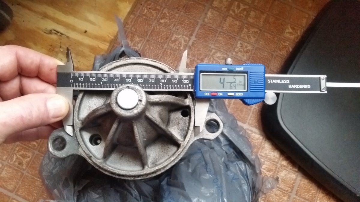

I checked Rock Auto's listings and they only show one starter for the 2.9. The 2.3 and 2.0 have a 3 bolt starter. Here's what I measured on an old 2.9 starter that I recently changed.
