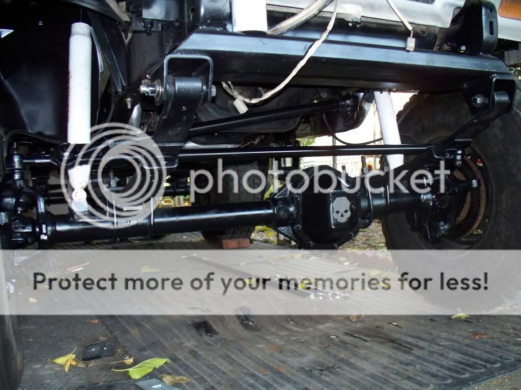

i use chevy rear blazer springs from like an 85 for my front currently, with a 60 and up to 44 inch tires with ok results...i still manage to "w" those springs though if i get stupid with it. on 33s i sit like 22 in at the frame on a gen 1 ext cab and 27-8 on 44's

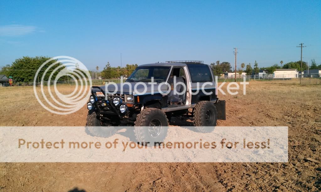

I used Rancho 44150 springs, which are 2.5" rear YJ springs in the front of mine. But they ended up being too soft, almost flat at ride height. My dad runs a spring shop, so I ended up building a custom pack off of the 44150 springs. IIRC I pulled the 2nd leaf out of the original pack and added two in it's place. The results were an increased spring rate from 235lbs to 250lbs, increased pack thickness by 3/8", and retained the factory spec free arch and length.
Once the springs settled, with my setup, I sit 7" over the stock BII ride height.
ON 39" TSL's

this is setup similar to jester with dodge springs...chevy 48's
chevy 52's with shackles forward. 6.5 v8 diesel that added 400 pounds with the 4l80.
