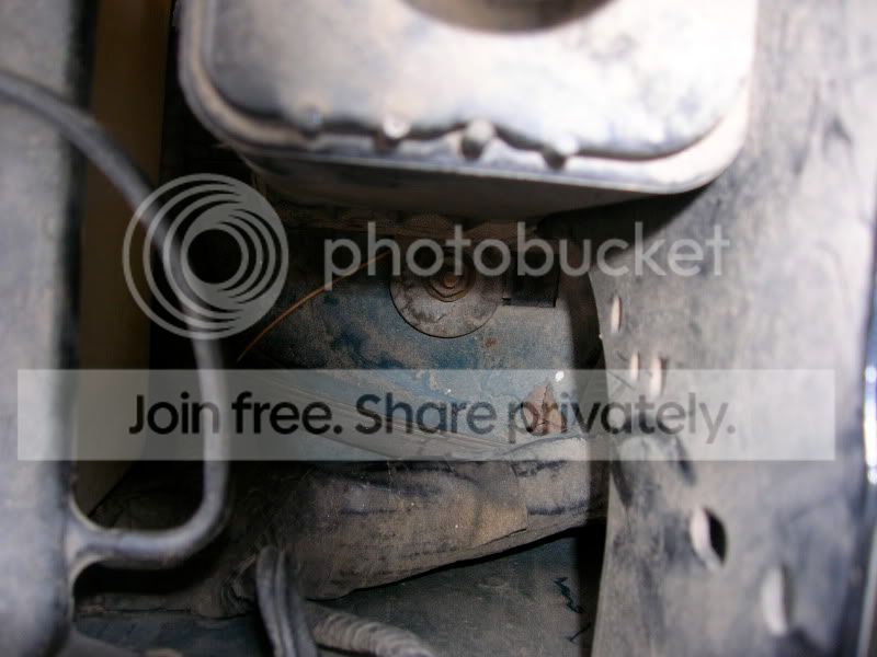

i can only find one plug in under the hood to run a scan tool, its red. were the hell is the other one?
heres the one im talkin about
i cant find another one
i got smart, went and got a book. found the scan tool hookups, i should find out what the deal is shortly. the cats arent glowing red.
