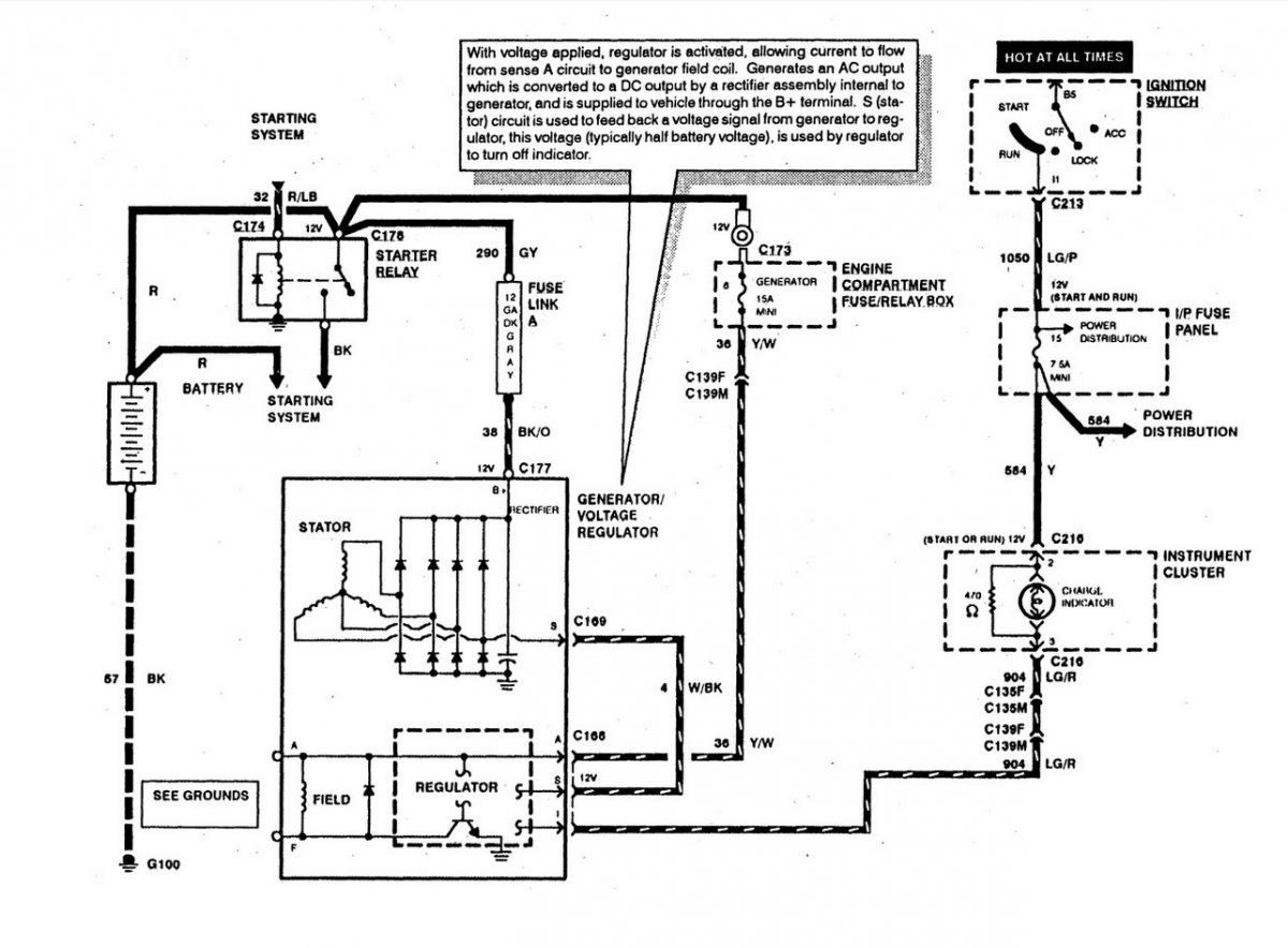

Below is the 1997 ranger charging system diagram I found. Do you have all that wiring from the starter relay to the alternator and the underhood fuse box? I would think that would have been part of the underhood wiring you got. And that is all hooked up? If so, you can see all you really need is one wire to come from the 1987 dash, the trigger wire to bring the alternator online to charge when the keyswitch is turned on.
If your 87 used a alternator dash light for the 87 system, you already have the same color lightgreen/red wire under the hood, or wherever it ended up. You will need to track down the 1997 lightgreen red coming from the 97 harness/alternator, and then track down the lightgreen/red from the 87 harness, and splice these two together.

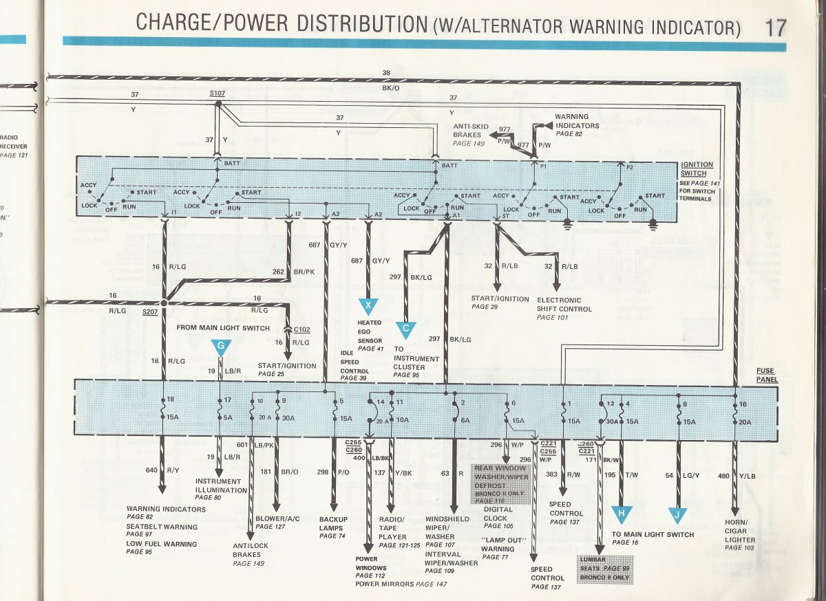

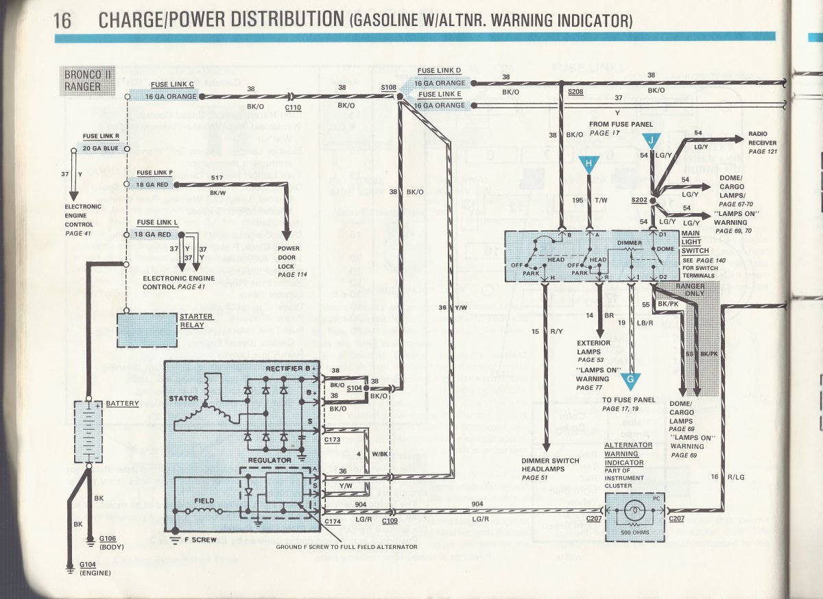

Below is a older diagram I picked up off this site. You can see along the top right is a yellow wire. This is one of the main feed wires to the older system to power it. Should be somewhat like the 87 has.
Below is another older diagram from this site showing how the yellow wire or wires feeds the ignition switch and it also goes on to feed part of the fuse box for power all the time parts of the underdash fuse box. You need to find these main yellow wires and also the black/orange that feeds the headlight switch in the 87.

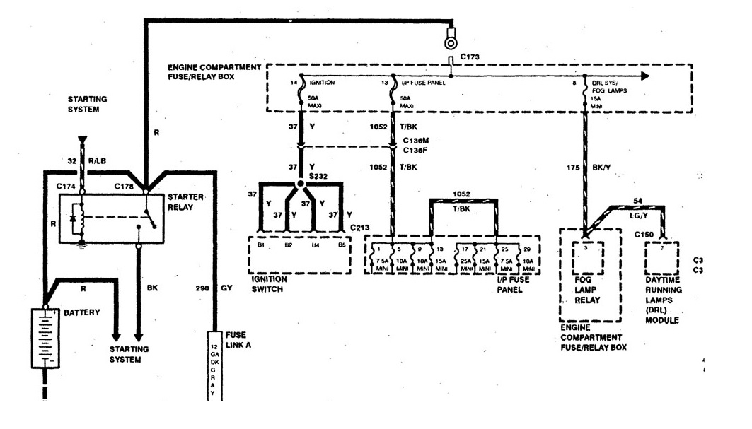

You can see in the 1997 ranger diagram below they also fed there ignition switch with a large yellow wire. They also separately fed the underdash fuse box. Both with large 50 amp fuses in the 1997 underhood fuse box. I don't have a accurate 1987 diagram, but if they fed both the ignition switch and the underdash fuse box in 87 with only one yellow wire, you may only want to use one of the 1997 circuits. Like the charge system wire, just find them and splice them together.

If those are 87 diagrams, looks like one single yellow wire. You are going to find it downstream from the 87 starter relay wiring.
