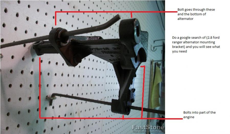

That's the bracket. Both the alternator and smog bolt into it. The top set of holes (as indicated in the picture), are where the bottom of the alternator bolts in. There is another set of holes (directly below the alternator ones, smaller width)...this is where the smog bolts in, if you're going to use it.
