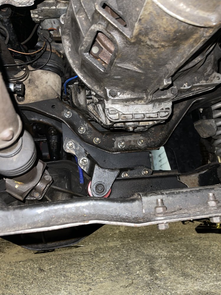

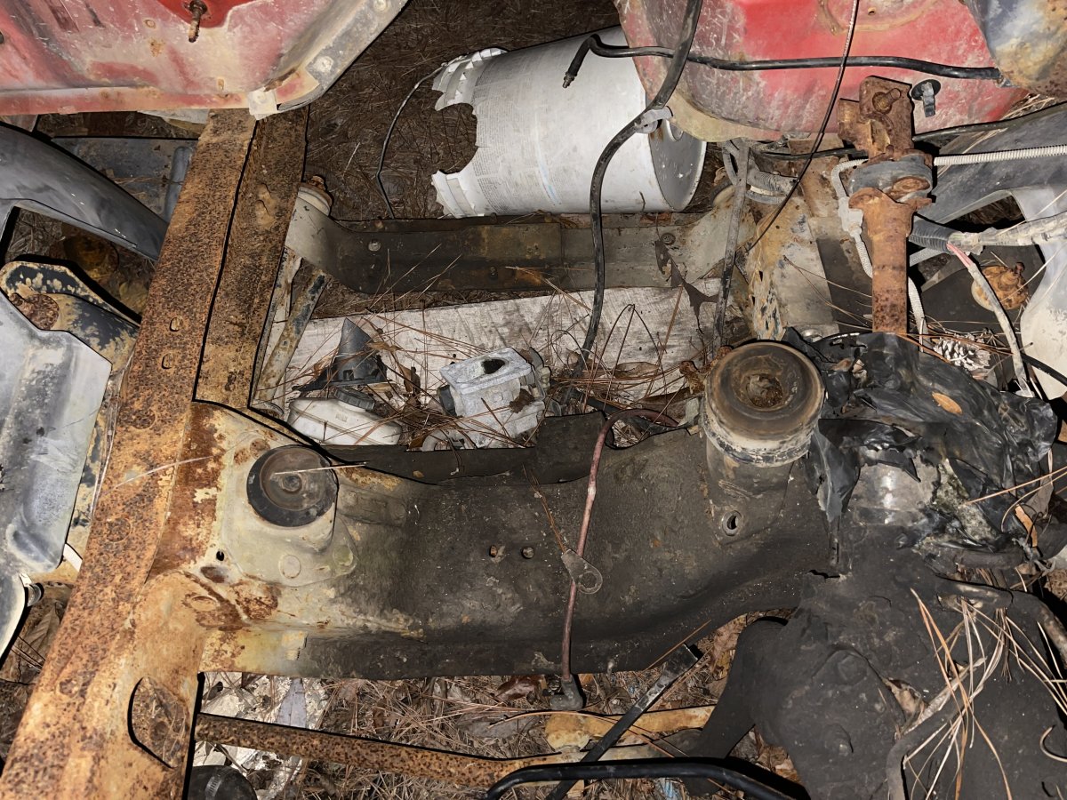

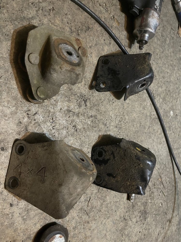

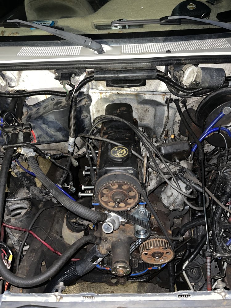

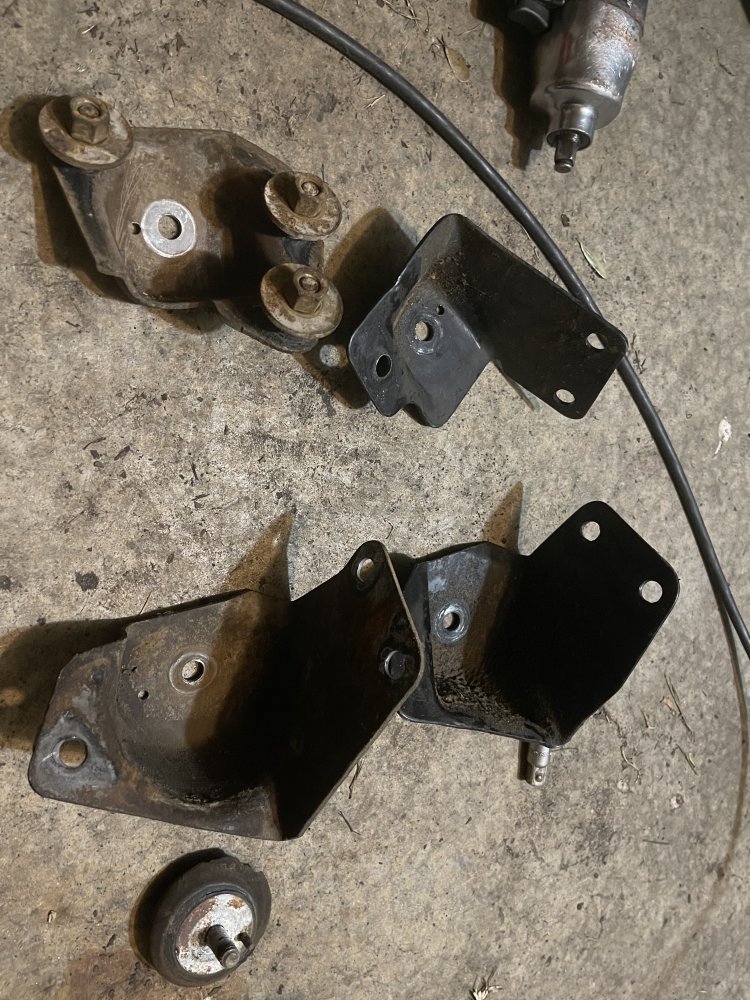

well god smiled upon us yesterday, guy hit me back and i drove 40 minutes out to check out the 86, sure enough, they were them. took some pictures for anyone else down the road who may find this, these are the brackets for the dana 35 and 28 crossmember it doesnt matter which one. truck was a 86 and had a 28 mines a 90 and has a 35 and they bolted up perfectly. FYI passenger side mount is a flaming pile of ferd. were real close to getting her running!

The engine mount brackets are not axle specific, just engine specific... if that was on a '86 apparently I was off on the year but good find! Those are rare for sure...
Be very wary of that drop plate bracket for the passenger axle beam pivot, they are very well known for breaking holes in Dana 35 differentials, not quite so much on Dana 28's since they're smaller, there's a thing on it in the tech library and in the 4x4 suspension section...
