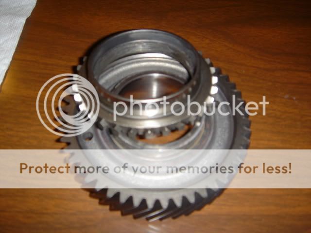

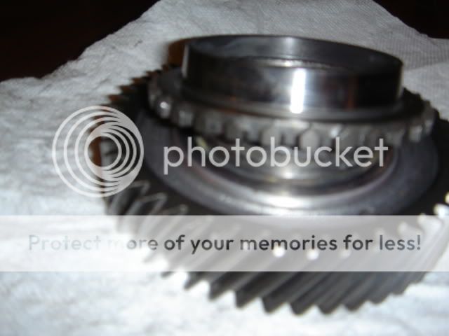

Alright, I think I've figured it out and I believe the countershaft 5th gear is broken. The dog teeth part of the gear have separated from main part of the gear. I still haven't gotten the nut off of the back of the mainshaft but I did turn the dog-teeth of 5th gear and the main part of the gear didn't turn. There was enough friction between the two that everything seemed to be working correctly but in reality when the slider collar engage the dog teeth the dog teeth would not turn the gear (with the applied torque coming from the tail tailshaft; backwards)
I don't see it in the diagram but sometimes the dog teeth are connected with the main gear with some steel keys. Could it be that the keys have sheared in mine (if it has keys of course)?
Tranny is apart! Looks like the weld broke between the countershaft 5th gear and its dog gear. The gears look good. I know it not a typical weld but does anybody repair these? Its lookin' like $100 for a new gear and $30 for the 5th gear bearing and $15 for the two nuts that I destroyed :banghead:.

I've seen the doog teeth broken off the gear twice on third gear.
I've never seen it done to 5th.
AD
And I wouldn't suggest welding a hardened gear or it won't be hard for long.
Just buy a new (or used but good!) 5th/counter-5th pair. Your favorite local transmission rebuilder should have a shelf full. Or you can buy new ones from an online source such as Phoenix Hard Parts (though I really would suggest a careful inspection prior to purchasing, which doesn't work by mail order).
The effect of welding on the heat treating is the least of the worries.
As a practical matter it's impossible to get the parts that have torn loose from each other parallel, concentric and "Square" to one another without the factory welding jigs.
Typically when 3rd breaks like that the two pieces will "Friction weld" themselves back together, but the synchro dog teeth are invariably "crooked" relative to the gear.
making it difficult to get into gear and prone to hopping out.
and making a nasty noise in any gear OTHER than that gear.
