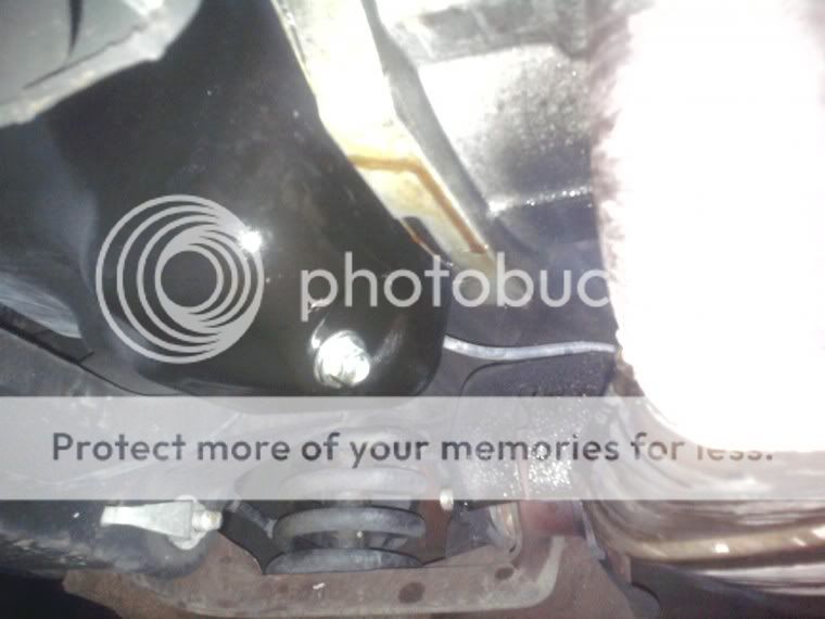

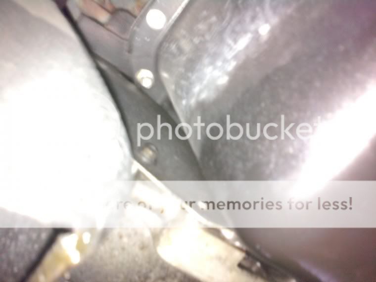

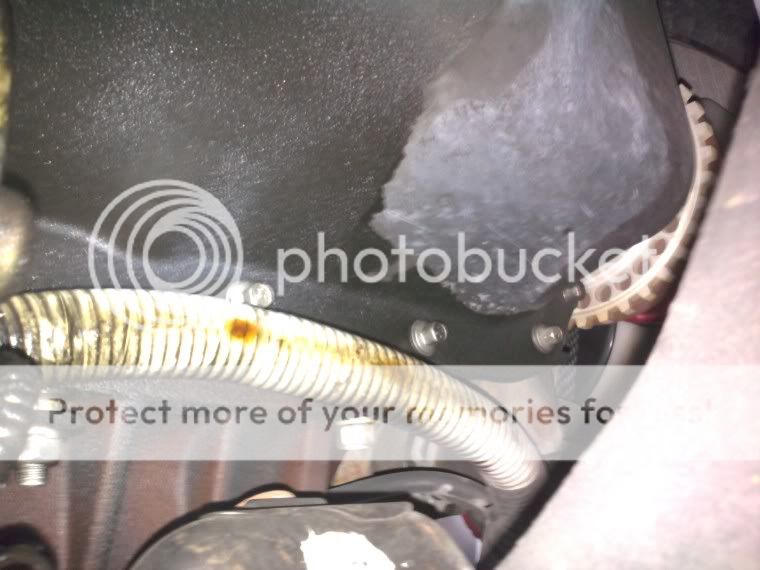

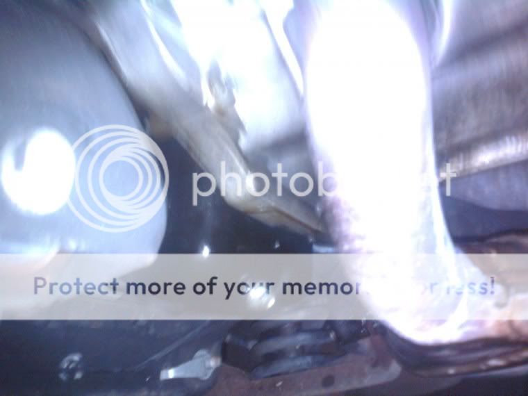

I thoroughly checked the engine while running it with a mechanic. We visually checked the valve covers, and I took a good close look at the oil filter. The leak begins to develop between the oil pan and the transmission. I'll upload my photos to show you.

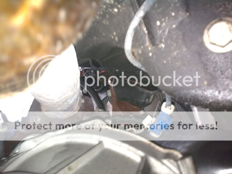

it may sound dumb, but i had a loose oil filter and the leak only showed up in the same areas as yours. i got a few suggestions when my leak showed up, one was the oil pressure sending unit on the passenger side. this is a bad pic i have of it, but it's diagonally up from the green and white connector (with two wires going to it).

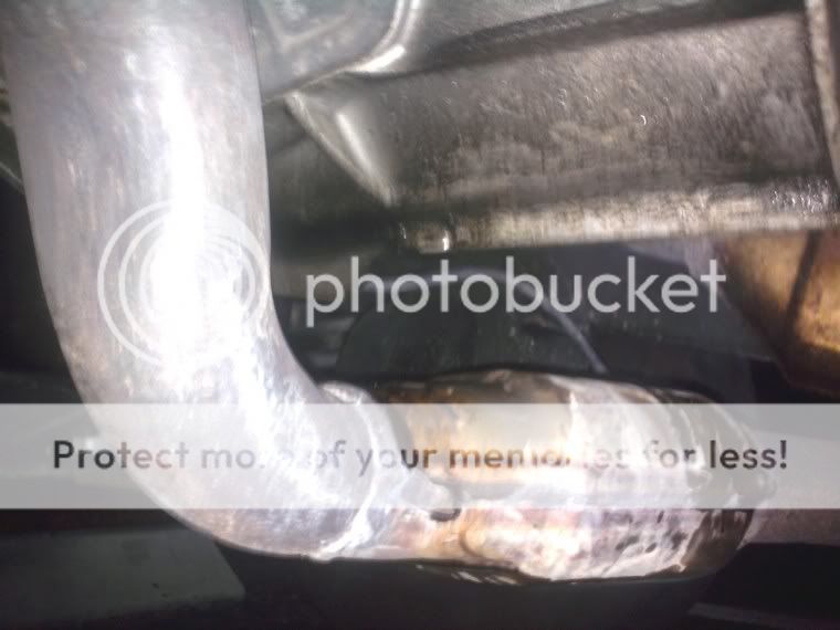

Leaking on the pre-cat
Coming from between the oil pan and the tranny

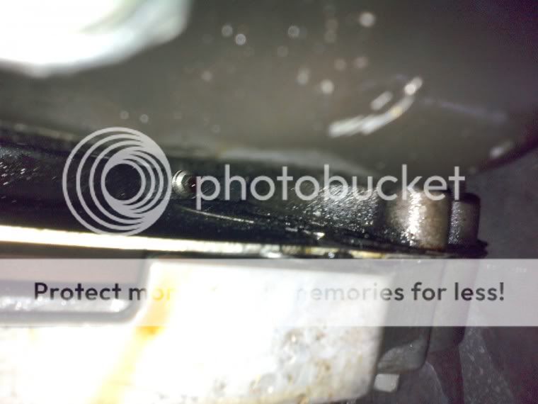

Second pic of the leak...
The amount of oil I lost in a matter of 10-15 minutes troubleshooting and looking for the cause of the leak
Another pic during the day while I was doing the troubleshooting...
Is it Rear Main Seal or is it Oil Pan Seal??? I've consistently overfilled the tank by accident, 5 qts instead of the 4.5 qts... don't know if that caused it or not...
Damn, that may be something to look at, where is it in relation to the tranny. Is that the tranny on the left and the engine on the right. Is it on driver or passenger side.

Okay I went out and looked it over with everyone's advice. The leak is coming from the driver's side (or from the main seal which would be center I guess), not the passenger's side. I've snugged the filter up a bit more as it could take about a 1/2 of a turn more, and I've got plenty of pictures...

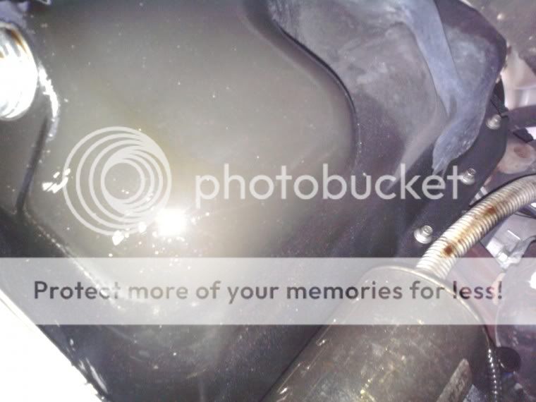

Showing more oil on the driver side vs the passenger side of the oil pan
Driver Side--wet
Passenger Side--dry

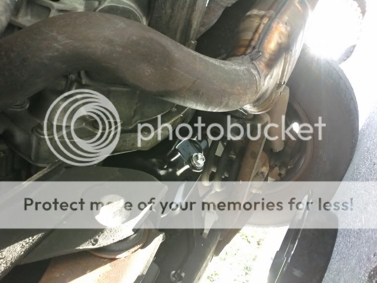

More Views of the oil scattered around the driver side of the oil pan...
View directly under the pan/tranny meet up...
The Oil Pressure sensor line thingy that u guys suggested to take a peak at... didn't see any oil anywhere on the passenger side, and definitely no valve cover leaks...

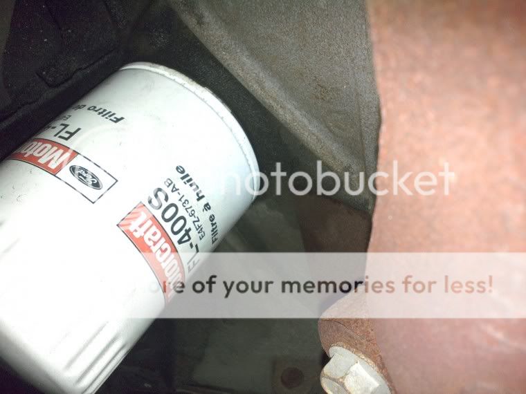

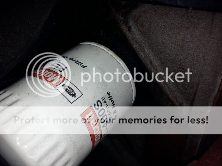

Finally, the oil filter. I just don't understand if it were the oil filter that it would have a chance to get by the little mini funnel that Ford built in to the filter area. It doesn't drip from the filter's self funnel it drips right beneath the tranny and oil pan area...
