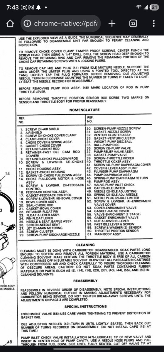

You mention accelerator pump "hose". Can you take a picture and post? All pumps I've seen are operated with rods and pumps are internal to the carb.
Disregard... I see a bunch of posts between when in wrote this and when I posted. I have a 1977 pinto with the 2.8, and there was a valve I hadn't ever run across. But it is a vacuum, to lean it out. Not sure about an enrichment valve but that could have been added in later years.

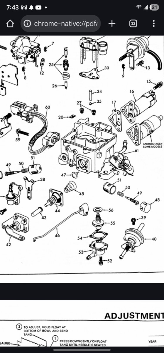

Number 53 is the one I was referring to.
Ah yes, I know that as the " power valve". I think that the diaphragm can rupture in those, especially if there was a strong backfire. I dont have any true knowledge of those so grain of salt is needed...
