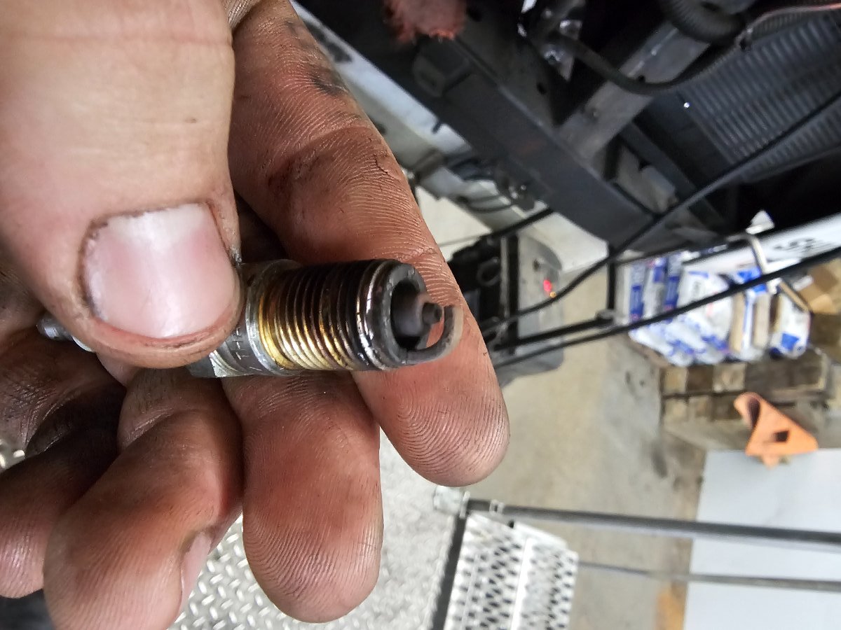

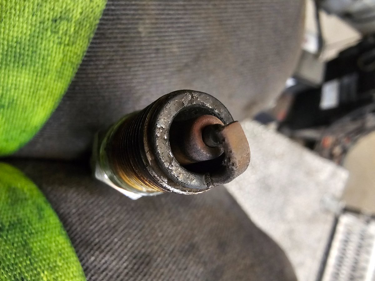

Didn't show a rich condition but more like fowling. Changed out plugs to a set i had taken out when I got it. Did change them when I got it. I assume rich because of it wanting to die at idle when sprayed with brake cleaner. Can try new plugs if you think it'd help. Just dont want to fowl more brand new plugs. Lol these are the last ones I took out. And all look just like this one.

Without knowing much more, I'd say you were probably right to change out the old plugs anyway-- unless I have documentation to indicate otherwise, as a habit I always do full service on any vehicle I buy, down to the last drop of fluid. In this case I doubt a spark plug change is warranted.

The plugs would typically be black or sooty, there will probably be a raw fuel smell especially out of the tailpipe, and the tailpipe may expell black smoke if it's running very rich.

Someone can chime in, but I suspect that it goes black when it's very rich as opposed to just slightly.
That was my impression as well. Just thought it might be rich on count of wanting to die with brake clean.
