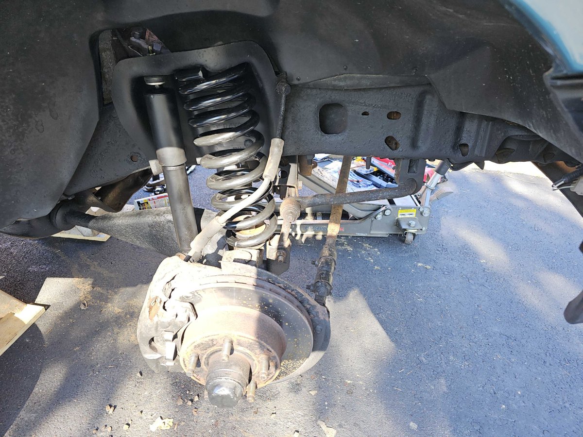

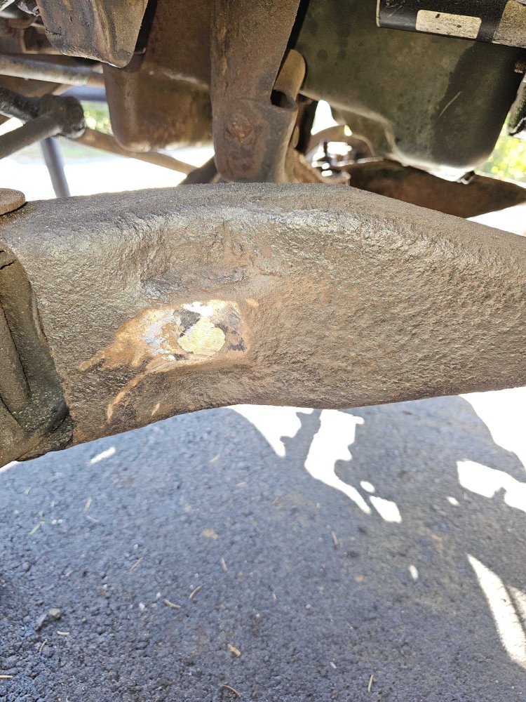

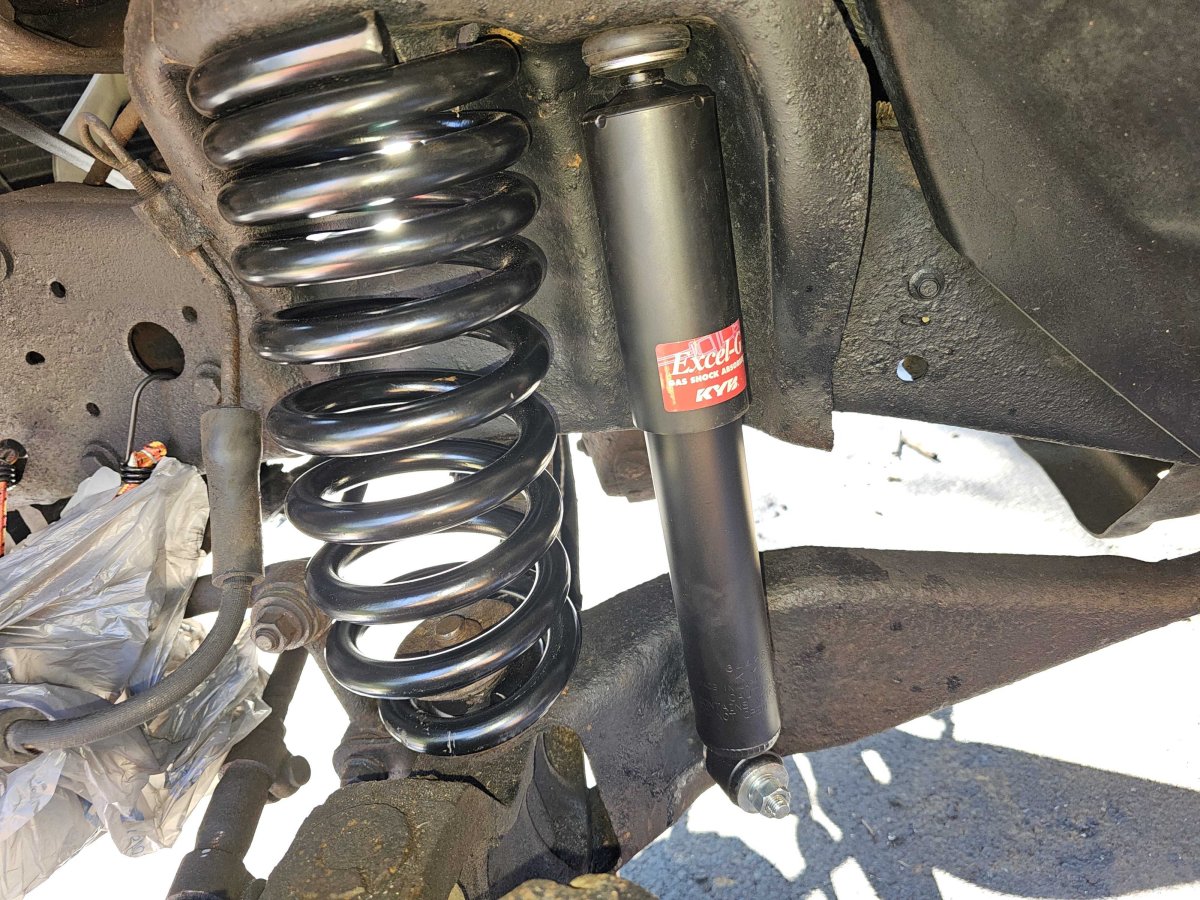

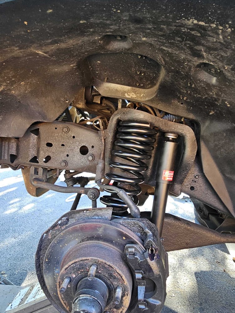

Ended up starting to replace the suspension on Monday. Got the front done. Had to grind off and replace a lower shock stud due to the P/O welding the nut on. This is temporary as I will need radius arms in the future (SUPER minor pin holes in both in non-structural areas).
By then I'll determine if I'm leaving it stock or swapping out the beams to lower it correctly.
YES I KNOW I PUT THE DRIVER SIDE SPRING ON WRONG
I'm taking it back off soon to orient it correctly lol
Doesn't look too bad for a Pennsylvania truck IMO

I have everything to do the rear, just haven't done it yet. Front spring hangers need done on them as well, but hoping to get by until spring when it's warmer.
Negative caster is hard on the steering rod ends. Ran the 4x4 adjuster on my '83 2wd with wide tires. Worked really well with (-) 2 degrees but ate rod ends every 30kmi. Switched to Heim joints and some custom CroMo tubing for the steering linkage & never looked back. Now you got the L.A. tilt. Nice looking job!

Ended up selling it. Replaced the front suspension and in the process found out the radius arms had pin hole rust, no biggy.
