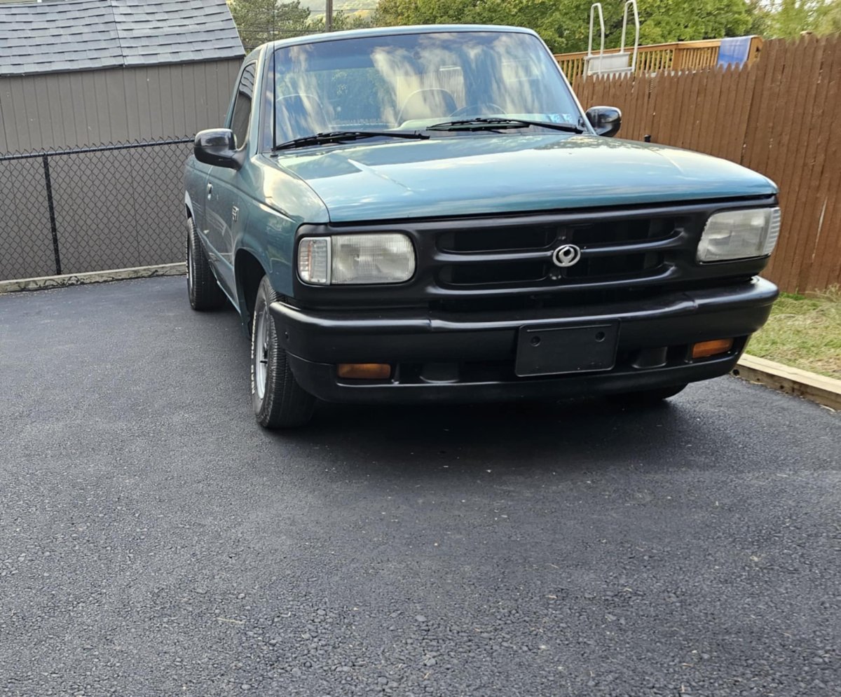

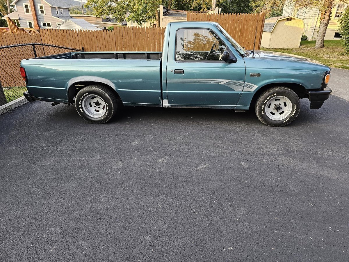

The truck has 205/70/14 on the front and 245/60/14 on the rear. A pic of the truck for reference:
Need help determining drop
I really dont want to go back to stock suspension just to turn around and lower it again eventually if I dont have to. I'd rather just replace the shocks with the proper length ones and put new bushings in the rear springs. It also needs aligned because the toe is out I believe and there's noticeable camber in the front

You are going to have trouble getting it aligned. It may be possible with different camber bushings that have a greater range of adjustment. But the TIB front end doesn't lower or raise politely by changing springs. The springs they put in have a lower load rating. So, they changed the load capacity of the front suspension. The best way to lower a TIB suspension is with different or modified axle beams, OR with offset steering knuckles designed for lowering it. Not sure if anyone even makes lowering knuckles for it. I have heard of people getting "dream beams" for lowering it.
On the rear, again, with that leaf missing, your load capacity is changed. It would be better to reinstall the missing leeafs and flip the rear spring hangars and shackles or switch to having the springs mounted under the axle instead of above it. The easiest way to do that is by swapping in an Explorer axle which has all the brackets already set up for a "spring under" design.
wow, they really lowered that truck. other than the camber on the front, it looks good.
fix that front and i would run it that way. thats how i want my truck to end up, or lower if i can get it.
Honestly the camber doesnt bother me, with proper toe, itll probably be fine. But it's running stock length shocks and theyre all blown out due to the drop.
If my measurements from the other guys are right, I think it's a 2/5 drop or like 2/4.5
Its within 1/2" front to back, so its almost 100% level lol

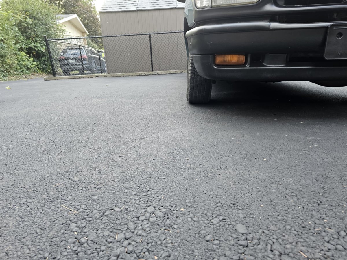

Looked and it's lowered way too low, it's sitting on the bump stops in the front.
That's why it rides so rough
