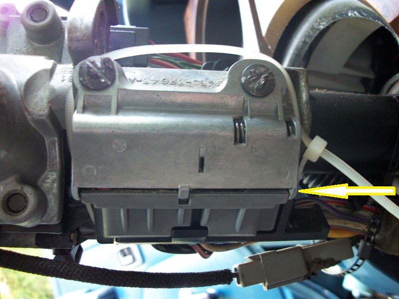

2) Test the Red/L Grn at the ignition switch itself. Two Phillips screws from underneath lets you pull the plastic cover pieces When you do this, look closely at the ignition switch- the electrical part a little lower on the steering column, not where the key goes. See if there's a gap between the metal and plastic parts, and give the wiring connector a wiggle to see if there's any looseness between the two pieces. It's not uncommon for these old ignition switches to get loose and cause problems; look for a gap like this:
If your ignition switch is loose, you can put a tie wrap around it (like in the pic) or replace it. If your Wht/L Blu is good but the Red/L Grn isn't good, that could be an alternative, but my own preference if it were my truck, would be to find and correct whatever is wrong with the original Red/L Grn ignition circuit.
He's right. If you can, get someone to mess with the ignition switch while you are checking for voltages. Sometimes if the switch isn't exactly in the right place you won't get voltage. If that turns out to be the case, I would replace the ignition switch itself.

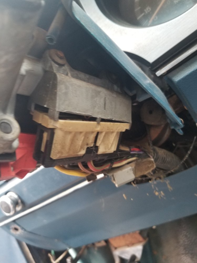

You totally nailed it! Zip tie fixed right up!! Man, I'd be up a creek without you two on this. Been changing all my own oil and fluids for 30 years, tune ups, suspension parts, brakes, clutches, drive shafts, a/c service, etc, etc. But other than stereo installs, and computer bypass on my '89 wrangler...little experience with auto electrical. Feel like I'm learning a lot....that will be helpful for many future projects. Thx for that!
