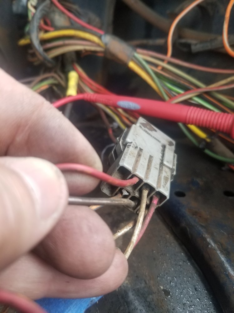

Seems to be some serious previous owner hackery going on or something. The c102 plug is were my oil sender, temp sensor, and 2 alternator wires terminate, correct? The two end slots there are no wires as mentioned such as red/L grn and brn/pink. Just empty holes with spider nests! If I probe with my meter, the bottom one in picture has 12 volts with key on. The top one nothing with key on, but around 9.5 volts when cranking. Would make more sense the other way around, run at 9.5 if resistor in harness, and full 12 v when cranking. I noticed the two wires on this plug (other than the 4 noted above) that were quite dirty. Cleaned them up and one appears to be brown with pink stripe. The other red with yellow markings that I suppose could have been light green back in the day. See picture. The 2 wires I'm holding in fingers. The brown/pink has 9.8v when engine cranking but nothing with key on position. The red/yellow wire has nothing on either crank nor on positions. Still need to come up with strategy to get power to coil...no prob adding resistor wire as previously suggested. Ideas gentleman? Thanks to you all!

As always, I appreciate every second you spend typing to assist on this project! RobbieD, your cheat sheet is super helpful, but I'm not seeing the red/L grn wire on the sheet. Is that somewhere else? I will put battery on charger to top it off, and disconnect wire from relay as suggested. Is it the one on bottom in this pic, that goes down to starter? But I'm sure my brown/pink is only powered in crank position at ignition switch. Odd?

Brn/Pnk and Red/L Grn should be crimped together in the terminal of C102 on the cab side. That ties the two circuits together (one hot in "run", the other hot in "start"). On the other mated connector of C102, on the engine side, the single wire carrying these combined circuits is supposed to Brn/Pnk, but it can also be Red/L Grn or Wht/Blu. This is the original coil power wire.
<edit> You can see this in the first wiring diagram that I put in post 15.
I found on mine, wire colors can look very different because of age and heat, but pulling fresher wire out of the loom or harness tape shows the true colors better.
On you starter relay, just pull straight out on the red rubber connector with the single small wire.
Yes, wire colors can look very different and I've been doing same thing, tracing back further to get truer colors. I get what you're saying now on cab side and engine side of plug...was having brain fart there. Will see what I got, and will check voltages with topped off battery, and unplugged wire at starter relay. Thanks man!!
