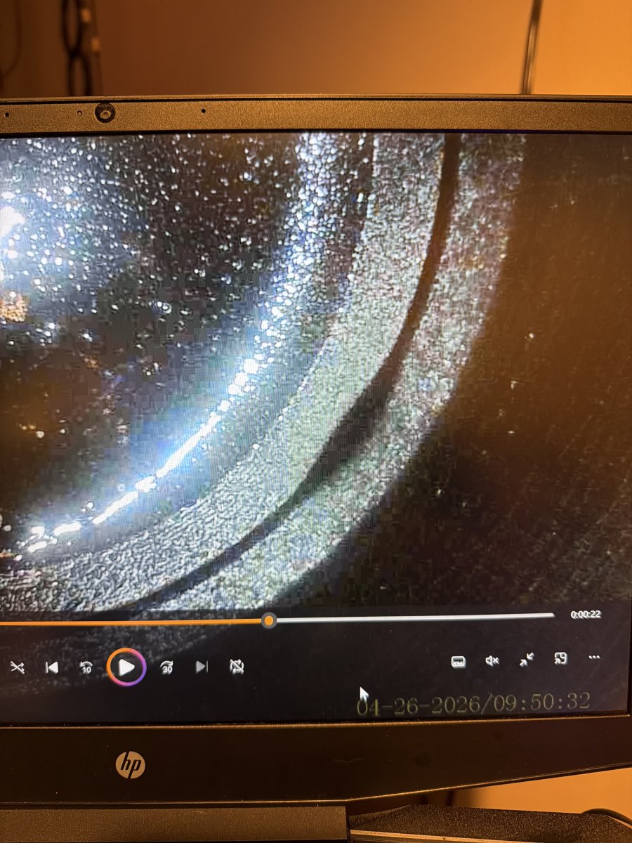

so i was getting ready to do a piston soak with berryman's b12 hoping i might just have some stuck rings. Before i did i decided to stick my borescope in there one more time and i think i found the problem
NEED ADVICE/HELP!!! low compression on cylinder 3 :(
Not sure how i missed that the first time and not even sure how that happens it looks like the edge of the piston got bent in
