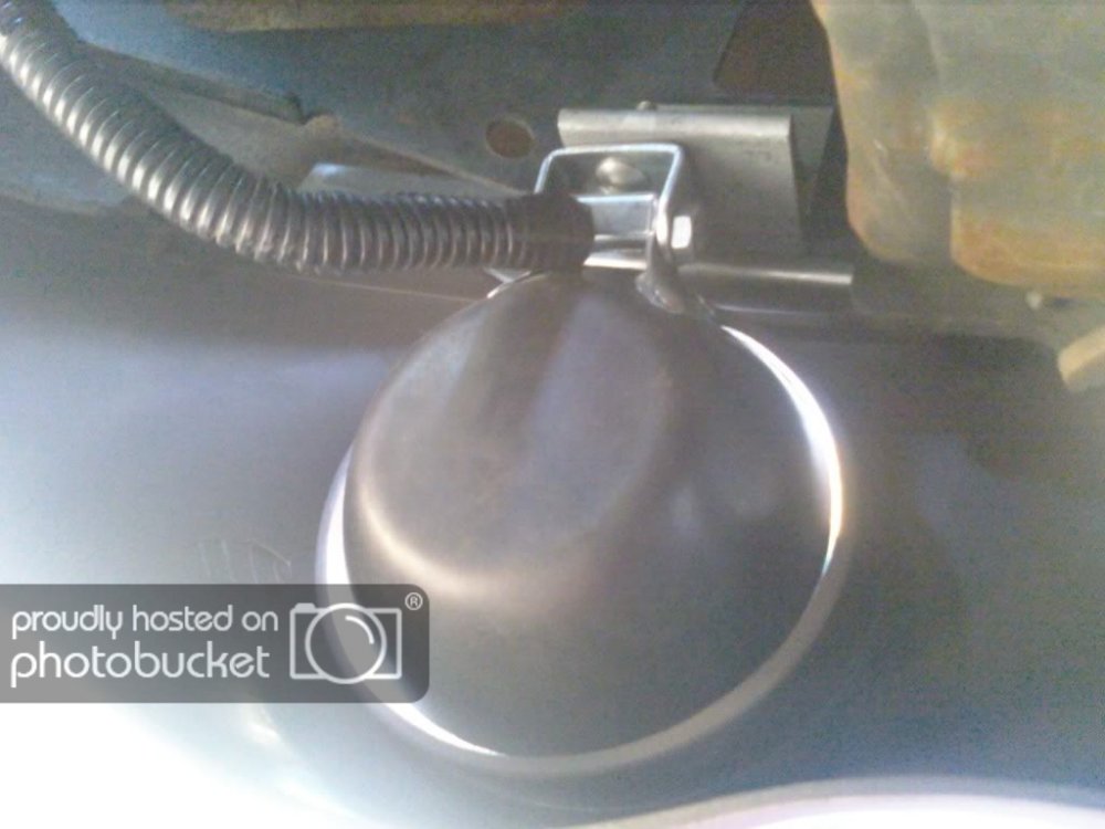

In my google searches i came across this photo of someone who fabbed their own brackets and used harbor freight lights.
29254
Looks like they just used a quarter inch steel angle. Seems sturdy enough to me.
I had found this one also, here on TRS, and put a link in one of my posts. While one bolt to the bumper bracket would hold the light like this guy did, my fist thought is, wont the angle iron turn shifting the light to one side a bit? I would have 2 easy options: 1. tack weld the angle iron to bumper bracket to hold it still, not may favorite option. And 2. make the bracket longer cut and beat the angle into it then weld the seam and use the second bolt hole. While it's more work the bracket wont turn and it would be usable on other brackets. The previous owner hit a a sand pile and tweaked the bumper so new brackets may be in the future but welding this project to the old ones seems a waste. At least that is my thoughts.
The oem brackets use the second bolt hole, so your option #2 would make better sense. You could also just bolt the same size steel angle into the first hole and bolt some flat stock to the second hole, tack where they meet and weld on the outside. Makes it easier instead of beating the angle into a long piece to begin with.
Thanks, now that you said that it make mores sense and less physical work to tack flat stock to it.

I stopped at my local Tractor Supply and grabbed 2" X 48" X 1/8" thick angle iron for the brackets. They didn't have a shorter piece so I had to grab the 48" or drive a few towns over to go to Ribco Supply for it. Tractor Supply was quicker and cheaper because of price of gas, disabled and on a budget here so frugal is the word for this project. Splitting the angle iron down its spine gave me the flat stock I needed to weld in to use the second bolt hole. The First thing I will need to do at this point is mark the bolt hole for the fog lights... Need them first so holding pattern till they arrive. Sadly I only had a small amount of flat black primer so they temporarily got sprayed purple till fully welded at which point I will have picked up more flat black and flat black primer for finish painting.
I almost feel like I'm in one of Edgar Allen Poe's poems on this project, Step by step, Inch by inch it is getting done.... A Rap, Rap Rapping At The Door (hoping that it's the lights being here)
If any one is interested in making a set: The angle Iron (2" wide and 1/8 thick) is 3-3/4" long and Flat stock is 1-3/4". I will need to cut and grind the angle in the flat stock but I need the angle Iron bolted first to know the angle needed, sadly in a holding pattern at this point. Ugg I want to keep going on it!! Excitement sets in here in my domicile.
