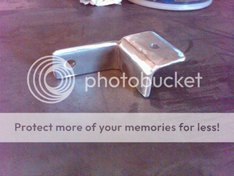

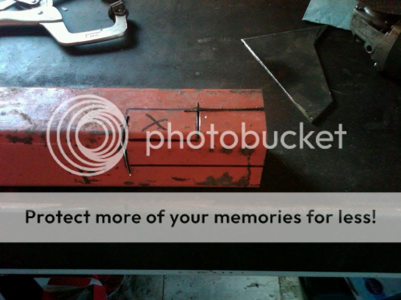

Hey man, yeah I did make it, range is a couple miles I think, I only use it for trail use so its good for me. I forgot to put the build of it in here, so here it is:

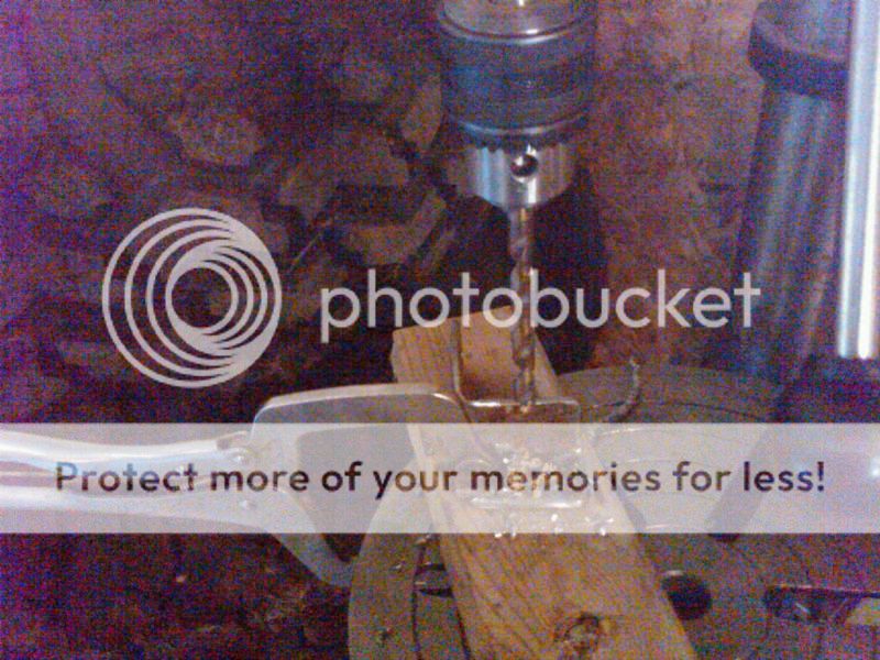

I made an antenna mount from some scrap steel...
Nathan's "The Rangebe"
bent some tabs....drilled some holes...can you tell what kind of tires those are in teh background? :P
and cleaned it up

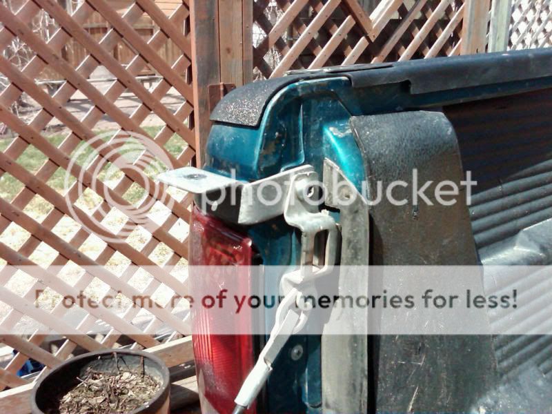

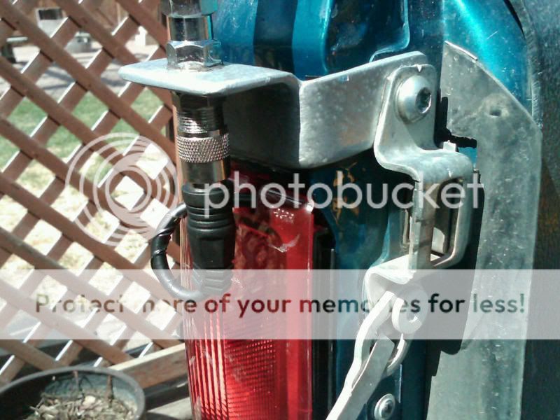

and heres how it mounts
better pic...antenna installed, and i ran the coax through the body, through the tail light

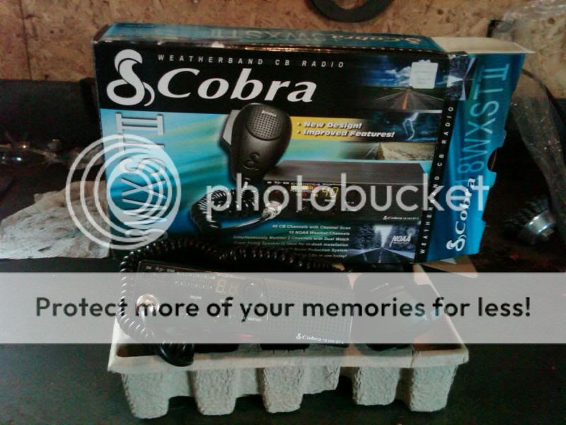

Heres the CB
I ran a hot wire into the cab through the hood release grommet, over to the passenger side and wired in a fuse block behind the passenger side kick panel.

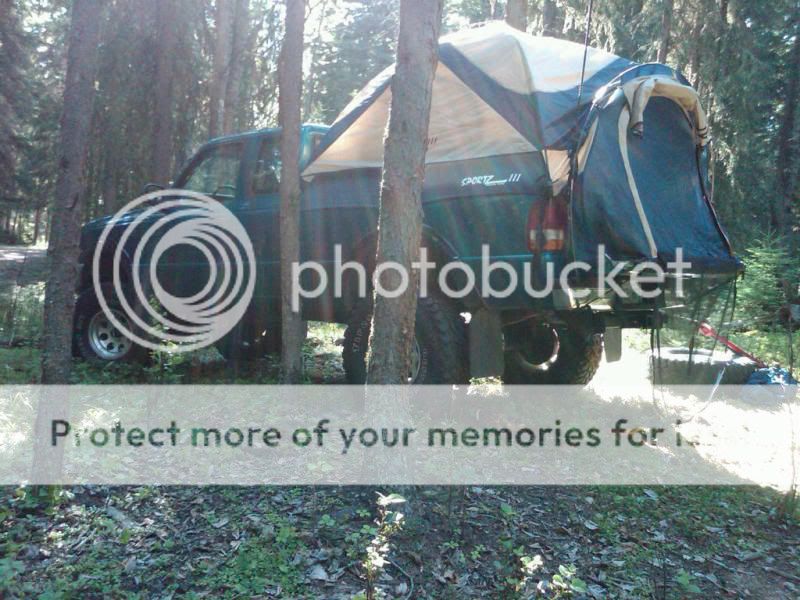

A pic from camping:

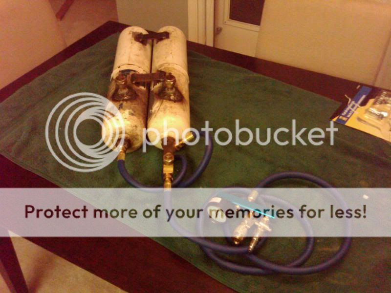

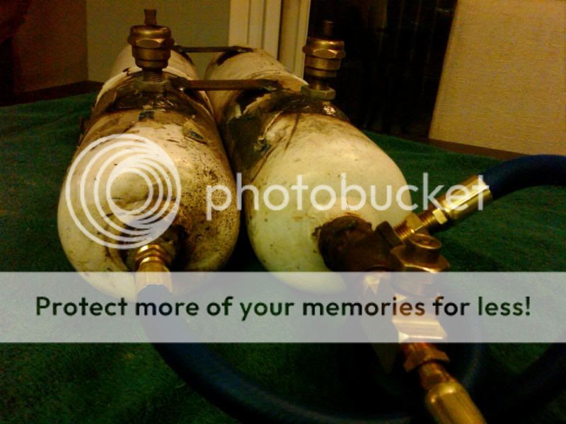

Hey guys so a little update. A buddy of mine gave me some old oxygen tanks, and with a little inspiration from Plumcrazy ( need to give credit where it's due) came up with this.

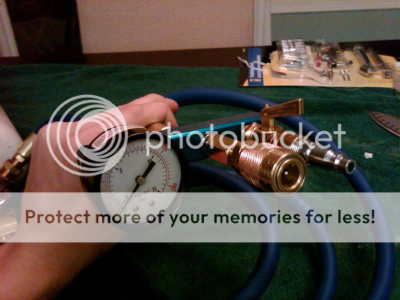

I will just keep it charged with shop air for now until I rig up a compressor. There are drain cocks on each tank. For safety there is a 250 psi pressure release valve. The line from the tanks will go the manifold, where there is a pressure gauge, as well as quick connects for filling and attaching an air line to.
I am going to pressure test everything before I put it under my truck (where the spare tire used to be) and run the manifold into the bed.
Keep looking for updates :icon_thumby:

Update....re-welded the bungs on the air tanks, my welds are air tight. However some of the brass fittings I bought were cheap and are leaking. Going to sort those out, and paint up the tanks.
Also ordered a compressor, I didnt want to drop a ton of cash on a real nice one now, so I bought a cheap one. Its 12 v, pulls 16 amps; max output is 150 psi, 1.4 cfm, and 50% duty cycle at 0 psi. It was only 93$, and as little as it will get used I dont care. Plus my tanks are only just over 2 gallons.
It will do for now.
