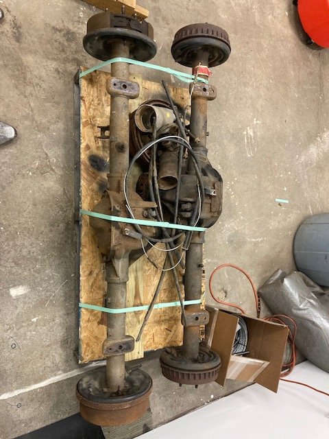

Good evening everyone. I picked up 2 Ranger rears to use in a project car we are building, but I have a question for you guys. The driveshaft is offset to the right side by 3-4” and I will need it to be centered or very close. I remember seeing someone using 2 short side tubes and axles to both shorten and center the rear ended. The person was doing it to an 8.8, but I can’t see any reason why it wouldn’t or shouldn’t work on the 7.5 rear. Has anyone done this? I apologize if it’s been covered before, but I searched and looked thru many pages with no luck.

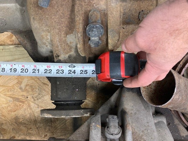

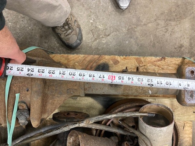

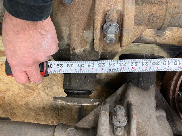

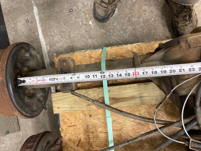

There are 3 plugs in each side, which in the video, were drilled/ground out and then the axle tube removed from the center section. I looked at these 2 rears and it looks do-able. The short side is approx 3” shorter than the left(longer) side. I think I can get it close to centered if it actually works.

We are building an MGB with a V-8 and we’re looking for an axle that would handle 250hp. The ranger 7.5 was mentioned as something that would be up to the task. I was able to grab 2 complete rears end-to-end for $80, so that is what I had planned to use. The overall width shouldn’t be an issue as I can play with that by using a different offset wheel. First things first, I need to get one rear cleaned up, unnecessary brackets removed and ready for modifying. I will take pix and document this whole adventure, good or bad, so my learning experience can be shared.
