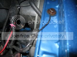

well first of all i can hear my windshield wipers through the radio.(The only real problem) but i don't know what to do with all my extra coax cable.(its just bondled under the radio) Or how to run it a little more permanently.(right now i have it taped to the door frame)

get the ground wire off that fender bolt, run it to the battery too, or to some other place where a known good ground can be had.
its not long enough to run it to the battery. and thanks for the help about the coax. its not a cobra

If your wire won't go to the battery then find a ground wire going to the body or under dash and put it there with that.
i would shorten the ground wire considerable. there is a large, metal support behind the center of the dash where mine is currently grounded. its close to the radio and dry. a ground loop isolator might help your interference noises, but it could also be from an improperly tuned antenna. do you know what your SWR is? if not, it is worth your time to buy a $10 SWR meter from radio shack or have the system tuned at a radio shop.
