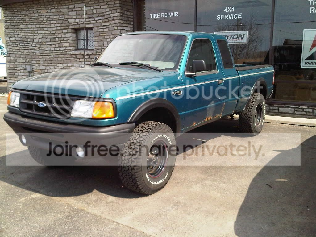

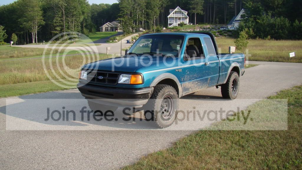

A before pic for reference:

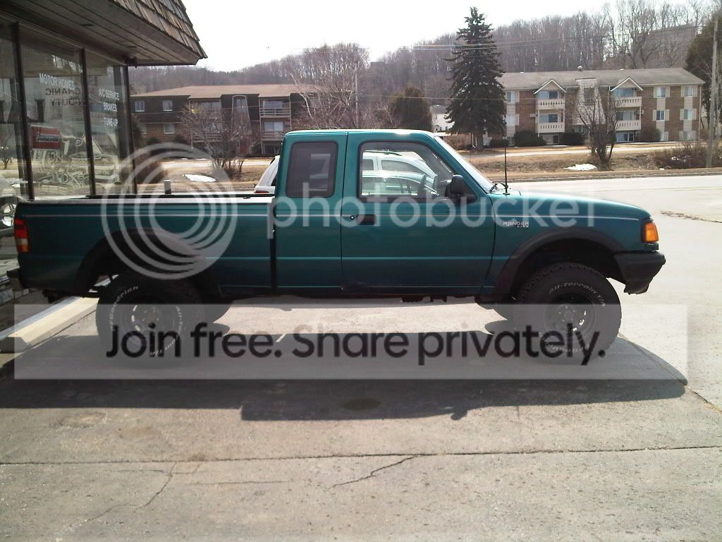

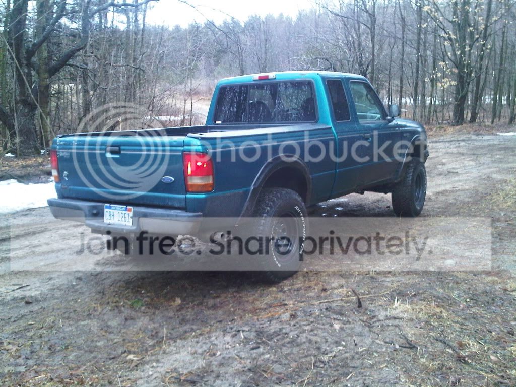

How she sits now:

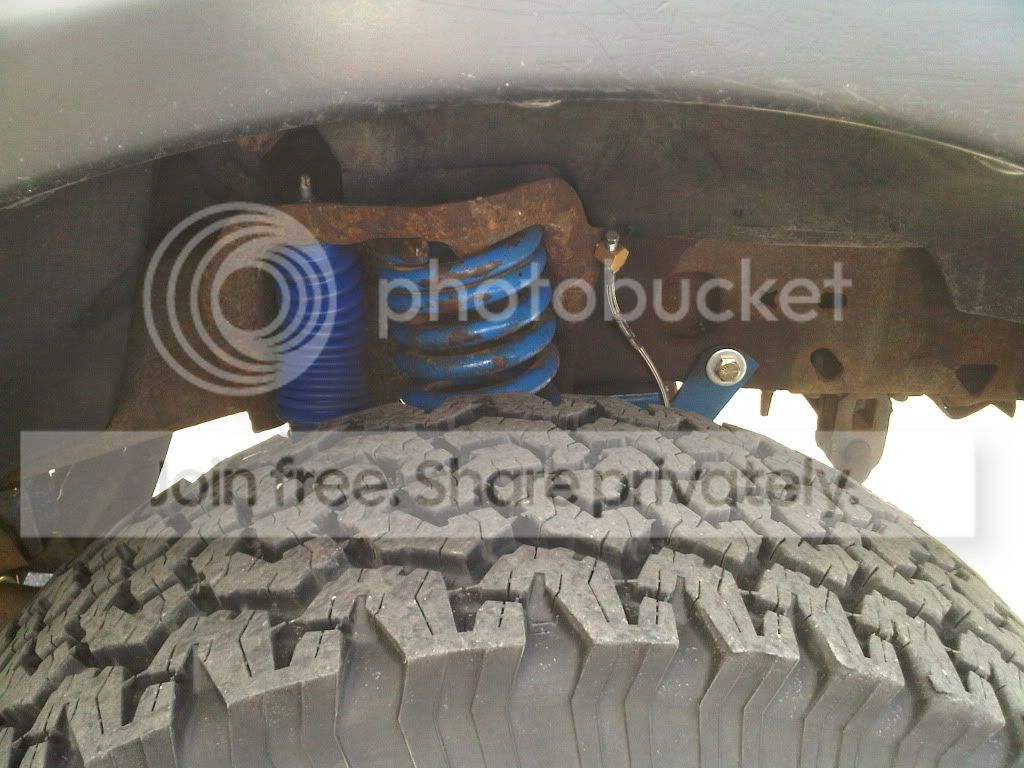

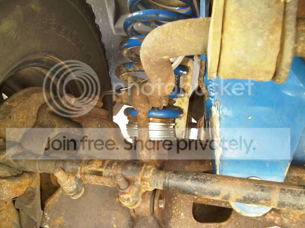

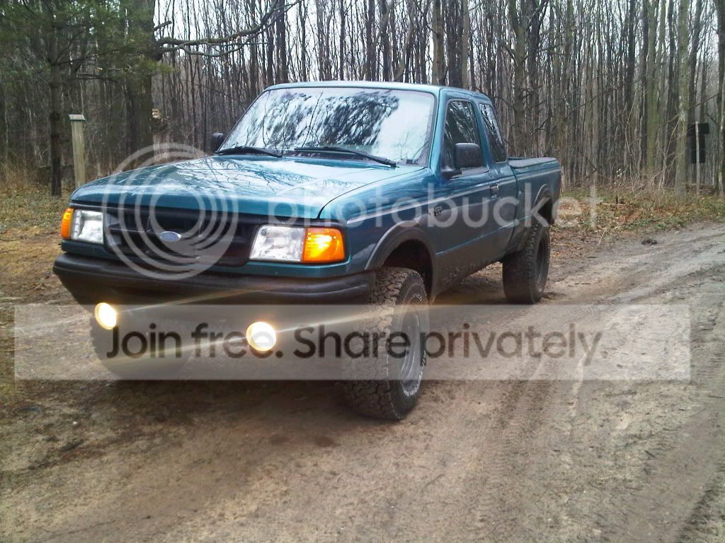

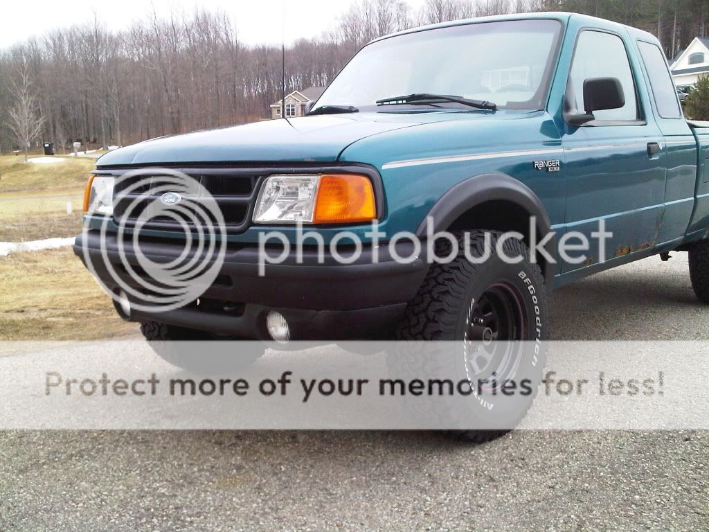

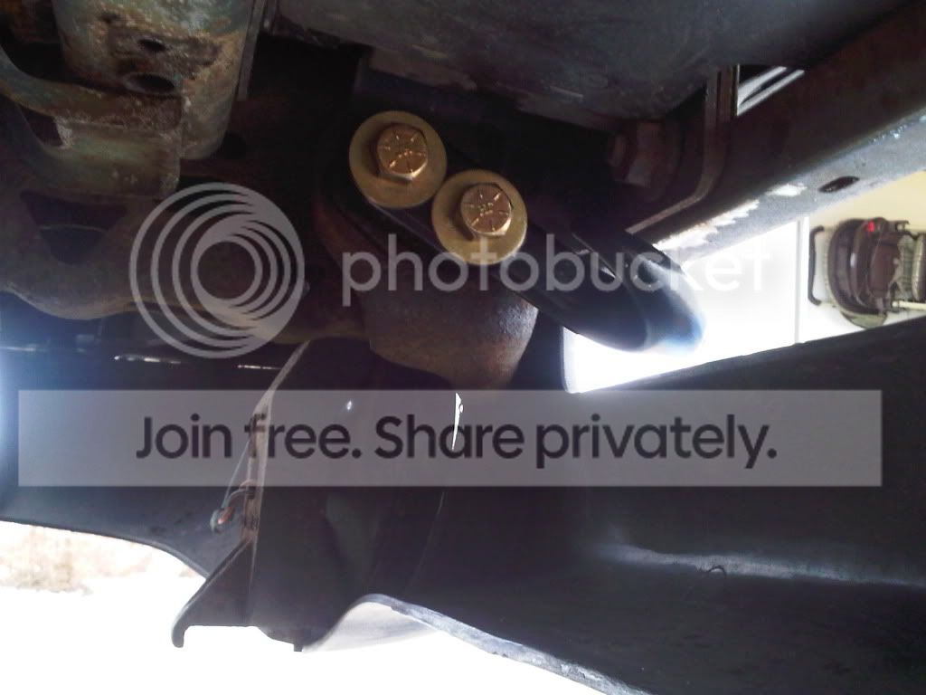

Had to add a few washers to get the right amount of lift on my supercab 4.0:
My Truck Transformation - 94 4x4
So I'm guessing I have about 3.5" of lift now, which I almost needed in order to get the pivot bolt about 1" above the hub's center-line as is suggested in the tech article section.
Stats:
James Duff 3" stage 1 kit (the brackets drop the radius and pivot arms 2 inches)
about 1.25" worth of washers as coil spacers
drop pitman arm (drops steering linkage 2 inches)
"new" leafs from a 2006 ranger with only 30k miles on them
1" lift shackles
32x11.5x15 BFG's on 15x8 cragar wheels with 3.75" backspacing
James Duff shocks in the front (8108's, good for 3-4" lifts)
ProComp ES3000 (32650)shocks in the rear
Man my 32's look small now.

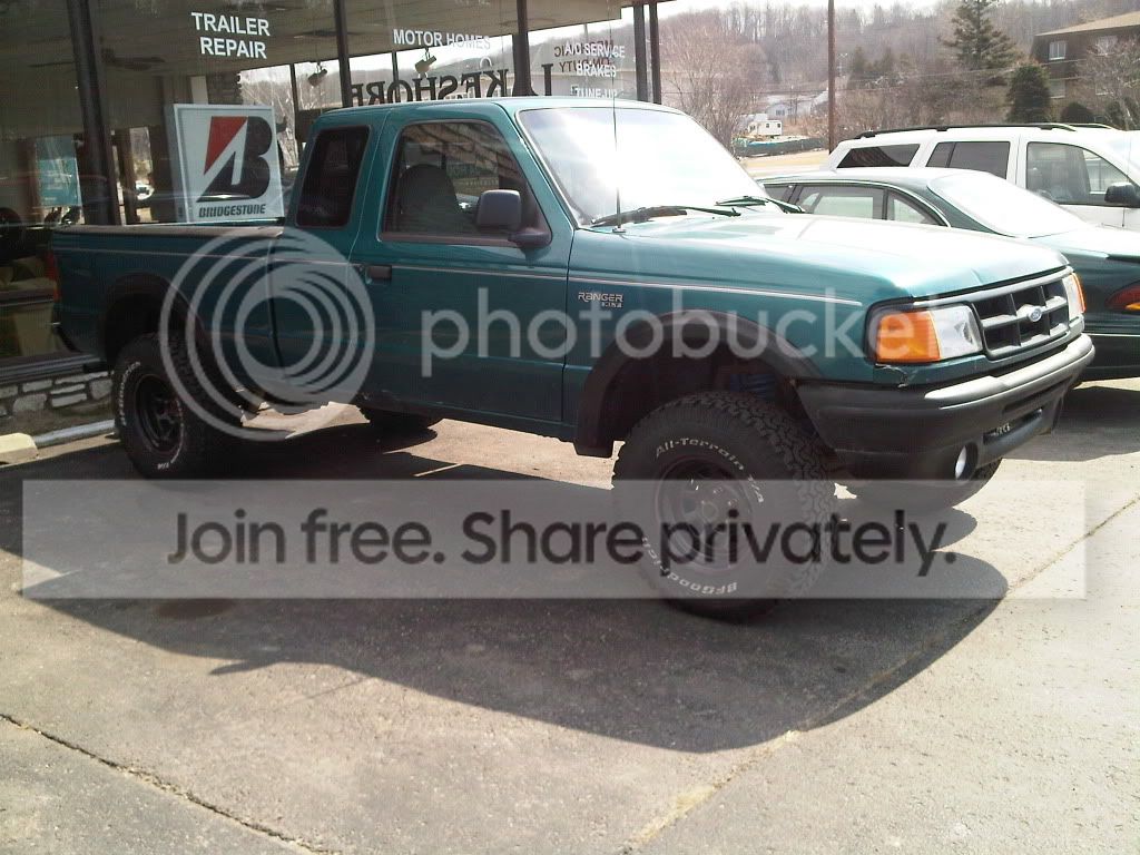

Do I need to go another 1" higher in the rear?
AAWWW Snap! That turned out awesome man!
outofstep, that looks like my trucks twin! good lookin rig ;)
Getting this thing aligned tomorrow, can't wait

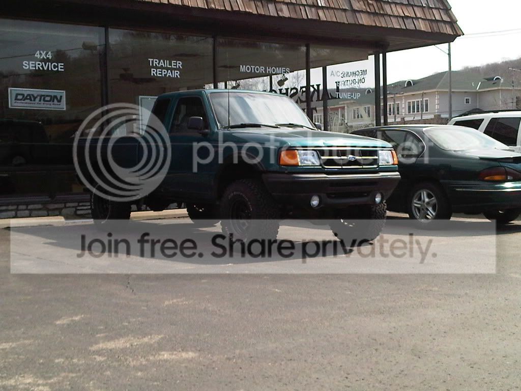

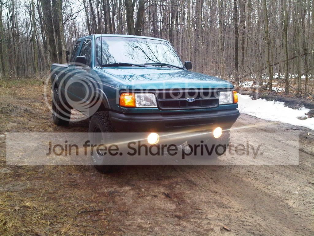

And hit the trails today
The duff shocks handle GREAT, very good manners on and off road. Now I have to plan to replace the procomp shocks in the rear with some duff shocks... the wife is gonna be pissed! :)

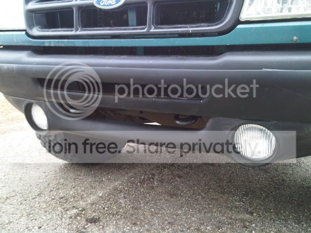

Be careful with those tow hooks, I have the same ones in the same place and from being pulled out and from pulling out fullsizes it bent the bumper brackets outwards, now I have to replace and gusset them.
Thats good to know! I certainly won't be doing any "yanking" with these primarily because I woudlnt' want to tweak my frame either. I just dont see any cross member support up front, its not till you get back by the motor. I just hope they'll be enough to get a little pull if I need it or vice versa.
