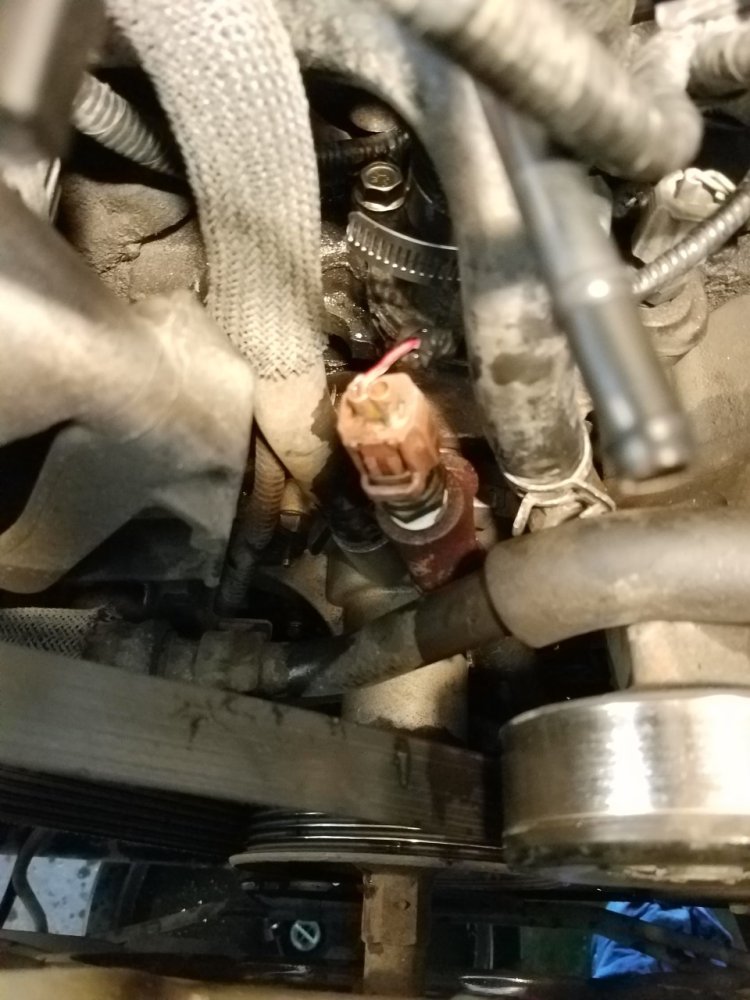

Dug into it yesterday. I chose to remove the thermostat, and refill it without the bugger, as it looked suspect. Lots of other things happening under there! (Shudder) Shade tree mechanics have nothing on the guys that were here before me. Check out my "new" mounting tube? for the temp sending unit. I don't think that this will be getting the right reading any time soon... Is there a place where I can get a look at what is actually supposed to be on the front of the engine for this little fitting? I am assuming that Ford did not use NPT at the factory. And is it available and not too costly? I feel good about the thermostat change, and will probably look for a 160 degree one around here, as the aluminum block is pretty cold in our winters anyway. (Red River Valley, Minnesota/North Dakota border boy)

Whew! I wanted to know about the sending unit, specifically. And maybe the actual fitting that is supposed to attach to the block.
